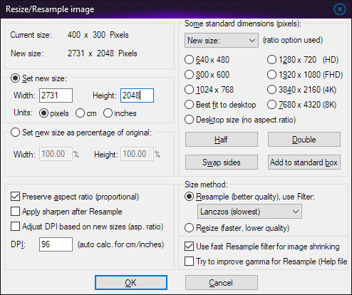

Personally, I would not expect it to round down. I didn't know it, but I'm so used to it rounding up. As an example, IrfanView wants to round up (see below). I would even venture to say that rounding down is not actually preserving the aspect ratio.
If I do 400 x 299 in Irfanview and then resize it (preserving aspect ration) back to 2048 height, my width is quite a bit off:
But if I stick with 400 x 300 and then resize it back up, original width is kept:

I would be surprised if there is any other popular program out there that doesn't round up. The expected result should yield the same dimensions when resizing larger or you are not maintaining the aspect ration. Regarding my third screenshot above, 2740 x 2048 is an aspect ratio of 1.337890625 which is not 1.333333333.
Unfortunately as bitmaps are measured in whole pixels, it's not possible to maintain the exact aspect ratio unless you resize to a multiple of the original size. 2731 x 2048 is 1.33349609375, which isn't 1.333333333 either.
