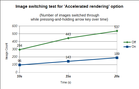

I just did some testing to count and compare # of images switched in Image Viewer while holding the arrow key. I did the comparison over 10, 15, and 20 seconds.
There's a big difference, and it's very noticeable when using it in practice, even when only switching a very small number of pictures with the mouse wheel.
  • Note: The green bar for 'Off' tappers down a bit on the 20s mark because my list of images was sorted by size, and the later ones were 5x larger file size than the beginning images, naturally slowing it down relative to the earlier images during the test. All tests were started from the same point in the file list.
  • Note 2: As a quick test, I just navigated down the file list while holding the arrow key for 10 seconds (no image viewing at all), and the file Lister was able to scroll through the same number of files (293) as the Image Viewer did with the accelerated render option off. So for the smaller images in the Image Viewer, the speed is capped by my keyboard repeat rate on my system. So, something is definitely hindering the image switching time with Accelerated rendering on.
