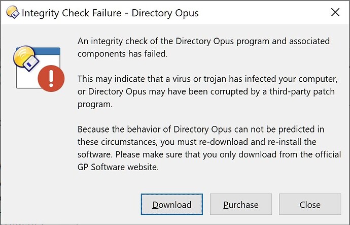

I keep getting a message that Dopus has failed an integrity test or the like, and still, I can open and use Dopus. When I go to the download site suggested, I find no free downloads, just commercial options.

I The error message is a long one, and it disappears before you can read it (another "improvement" of websites). However, it is one that is probably well known to you: the integrity check that failed. I checked another post and saw your answer of checking digital certificates, which I did one a few of the more important files. All well. I then run SFC and if found faults and repaired them. I just looked at the log file, but it is like a black wall to me (don't know what to look for to see what repairs were done).

Several security scans later, and no viruses discovered, today, I was transferring a large file between HDDs, and the Error message about Integrity check failed came up and closed Dopus. 2 hours of transfer down the drain. Do the developers know anything about this issue? Can anyone help?
The message doesn't appear randomly. It's indicating that something has modified the Opus executables/DLLs.
Make sure there's nothing in the Opus program files folder that wasn't put there by our installer, and re-check the signatures on all the exe and DLL files under it.

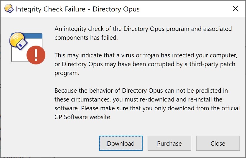

Jon, I did not go to bed. I discovered that there was a new version (13.23), and I installed it. Got an error message (hopefully attached here). Tried to install again, but was told I had the latest version. In dopus.exe, I now have this signature date: ‎Wednesday, ‎May ‎13, ‎2026 4:34:31 AM. Please advise. Hans L
Download the installer and re-run it. It will always let you install even if it's the same version you already have.
