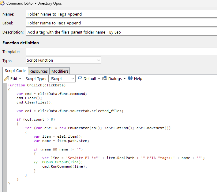

When running the jscript Foldername_to_Tags_Append, I have a few files (23 out of over 66K) that kicked off a set attributes error. The bug part of this seems to be that even though I select "Skip all Conflicting Files", the script halts at each one individually until I manually hit skip again.

The script was written by Leo and I love it. Since I don't do a lot of scripting, I wasn't aware that "skip all conflicting files" may not be an option for this kind of operation. I would've thought if you can skip a file, you could skip all similar files.
I will enclose the script.
Your script is running a separate command on each file. Each command only acts on a single file and has no knowledge of the next file or command (they haven't even been run yet, so it would be impossible). The Skip option will only skip the file for the current command.
Ah, I see. Thank you for explaining this to me, Leo. Would it be feasible to add code to set a flag or something comparable to do a check and keep going so I can run this as a batch job overnight?
