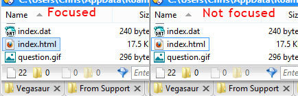

This works great, the only thing that is not what I want, is that after I launch the file it is left with a hollow box around it and not with the blue selection box which I think is called focused. With this hollow box it is not ready to be launched again from another application, I have to click it with the mouse to turn it selected again. How could I get this file to remain focused so I don't have to click on it again?
