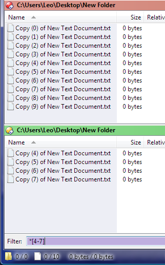

It works fine here

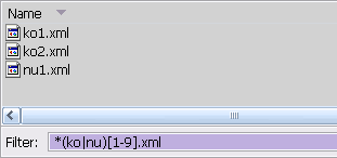

leo, take a look at my post - it really works
Send it here: gpsoft.com.au/Support.html
That's a wildcard expression. (It's also a valid regular expression expression but that's just luck.)
( | ) all work with wildcards, too. (In Opus, anyway. The definition of a wildcard varies, of course.)
btw the [0-9] is not working for me... e.g. when u try [4-7] im still getting all digits
