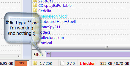

Hmm If I typ *zip it works..
If I type ** it still shows ony the filter.. not everything same with :
any ideas?
using 9.1.1.7.3307 x86

yes understood that is what i'm doing and it's not working..
if I type it (**) in the filter box directly it works as expected. but if i use ** in the on the fly find as you type it wont switch back to all files from whatever filter i am in.
Is this clear or am I wording things oddly?

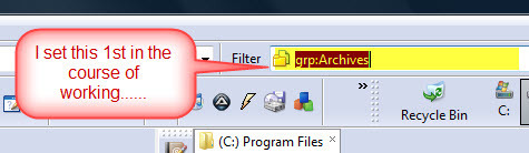

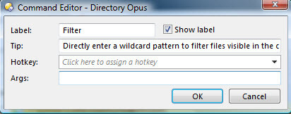

I've asttached screen's to help... mode.. well i'm browsing locally.. files an folders.. no custumization on the filter command box ex. posted.. I'm thinking it's user error... isn't it... :open_mouth: :open_mouth:
You're mixing two different types of filters.
The FAYT field changes the "View Filter".
If you want to use the FAYT field and the toolbar Filter field interchangeably then you need to set the toolbar Filter field to use the "View Filter" mode.
You can do that by using the drop-down menu you get when clicking the icon on the of the toolbar Filter field. If you want it to stay in that mode, customize it (as shown in your first screenshot) and add local into the Args string.
(I've got no idea why the argument calls it "local" but the menu calls it "View Filter" :slight_smile:)
