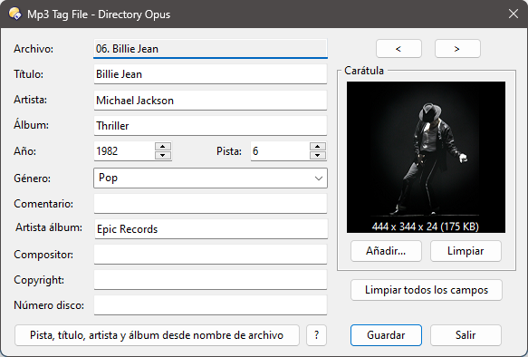

Mp3 Tag File (Built)
@errante, it took a bit of work, but thanks to your invaluable help, I got it right, now the Gender field is filterable. I'm leaving the commented script here because maybe some newbie like me could learn something from it. I just want to thank you once again.
Mp3 Tag File 1.4.js.txt (23.8 KB)

==SCRIPT RESOURCES
<resources>
	<resource name="Mp3TagFile" type="dialog">
		<dialog fontsize="9" height="193" lang="esm" title="Mp3TagFile" width="332">
			<control halign="left" height="8" name="archivo_t" title="Archivo:" type="static" valign="top" width="48" x="8" y="8" />
			<control halign="left" height="12" name="archivo" readonly="yes" type="edit" width="148" x="58" y="6" />
			<control halign="left" height="8" name="titulo_t" title="Título:" type="static" valign="top" width="48" x="8" y="23" />
			<control halign="left" height="12" name="titulo" type="edit" width="148" x="58" y="21" />
			<control halign="left" height="8" name="artista_t" title="Artista:" type="static" valign="top" width="48" x="8" y="38" />
			<control halign="left" height="12" name="artista" type="edit" width="148" x="58" y="36" />
			<control halign="left" height="8" name="album_t" title="Álbum:" type="static" valign="top" width="48" x="8" y="53" />
			<control halign="left" height="12" name="album" type="edit" width="148" x="58" y="51" />
			<control halign="left" height="8" name="anio_t" title="Año:" type="static" valign="top" width="48" x="8" y="68" />
			<control halign="left" height="12" name="anio" number="yes" type="edit" updown="yes" val_min="1" width="50" x="58" y="66" />
			<control halign="left" height="8" name="pista_t" title="Pista:" type="static" valign="top" width="18" x="136" y="68" />
			<control halign="left" height="12" name="pista" number="yes" type="edit" updown="yes" val_min="1" width="30" x="157" y="66" />
			<control halign="left" height="8" name="genero_t" title="Género:" type="static" valign="top" width="48" x="8" y="84" />
			<control edit="yes" height="40" name="genero" sort="yes" type="combo" width="148" x="58" y="82" />
			<control halign="left" height="8" name="comentario_t" title="Comentario:" type="static" valign="top" width="48" x="8" y="99" />
			<control halign="left" height="12" name="comentario" type="edit" width="148" x="58" y="97" />
			<control halign="left" height="8" name="artista_album_t" title="Artista álbum:" type="static" valign="top" width="48" x="9" y="113" />
			<control halign="left" height="12" name="artista_album" type="edit" width="148" x="59" y="112" />
			<control halign="left" height="8" name="compositor_t" title="Compositor:" type="static" valign="top" width="48" x="8" y="129" />
			<control halign="left" height="12" name="compositor" type="edit" width="148" x="58" y="127" />
			<control halign="left" height="8" name="derechos_t" title="Copyright:" type="static" valign="top" width="48" x="8" y="144" />
			<control halign="left" height="12" name="derechos" type="edit" updown="yes" val_min="1" width="148" x="58" y="142" />
			<control halign="left" height="8" name="numero_disco_t" title="Número disco:" type="static" valign="top" width="48" x="8" y="159" />
			<control halign="left" height="12" name="numero_disco" type="edit" updown="yes" val_min="1" width="148" x="58" y="157" />
			<control height="14" name="btn_desde_archivo" title="Pista, título, artista y álbum desde nombre de archivo" type="button" width="181" x="8" y="174" />
			<control height="14" name="btn_ayuda" title="?" type="button" width="14" x="192" y="174" />
			<control height="12" name="btn_anterior" title="&lt;" type="button" width="30" x="236" y="6" />
			<control height="12" name="btn_siguiente" title="&gt;" type="button" width="30" x="273" y="6" />
			<control height="122" name="caratula_t" title="Carátula" type="group" width="113" x="212" y="21" />
			<control halign="center" height="8" name="resolucion" type="static" valign="top" width="100" x="218" y="112" />
			<control halign="center" height="86" image="yes" name="caratula" type="static" valign="center" width="100" x="218" y="32" />
			<control height="14" name="btn_anadir_caratula" title="Añadir..." type="button" width="46" x="220" y="124" />
			<control height="14" name="btn_eliminar_caratula" title="Limpiar" type="button" width="46" x="270" y="124" />
			<control height="14" name="btn_eliminar_todo" title="Limpiar todos los campos" type="button" width="97" x="220" y="147" />
			<control default="yes" height="14" name="btn_guardar" title="Guardar" type="button" width="46" x="220" y="174" />
			<control height="14" name="btn_cancelar" title="Salir" type="button" width="46" x="270" y="174" />
		</dialog>
	</resource>
</resources>
