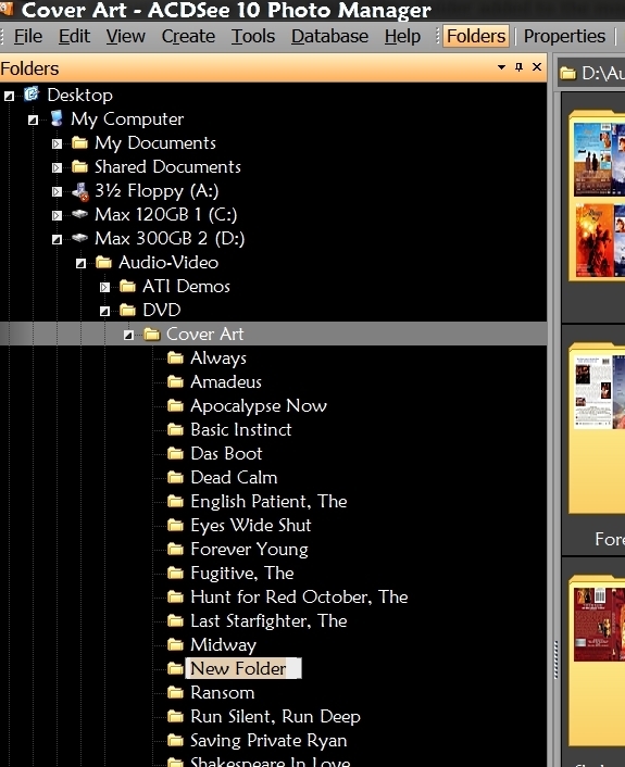

I don't understand. What do you want to left-click to create a folder? Maybe a screenshot would help if this is something other programs do.
See attached JPEGS from two programs (FastStone Image Viewer and ACDSee image viewer)
Doc
More
More
More
Thats all;
Doc
Oh, you mean right-click not left-click? (Or your mouse buttons are swapped to normal.)
