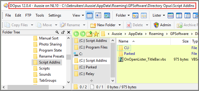

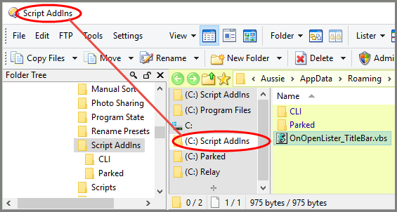

I start with a single lister as shown immediately below. This is the current (default) lister and it has no custom lister title. So far so good, everything looks OK.
Now I close the (only) lister and open a new one via right mouse click on the Opus system tray icon and Open New Lister. The custom lister title is as expected, everything still looks OK.

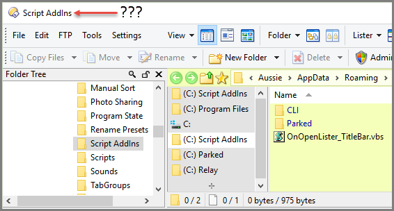

Now I close the (only) lister again and open a new one via right mouse click on the Opus system tray icon and Open New Lister. The custom lister title has gone! If I repeat the process, every alternate new lister has the custom title and every other lister does not.
The same alternating behaviour can be demonstrated by a sequence of Go NEW commands or opening and closing new listers by means of Win+E.

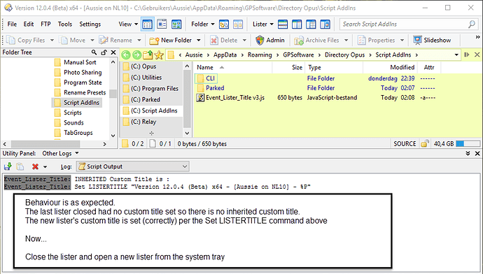

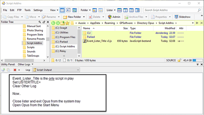

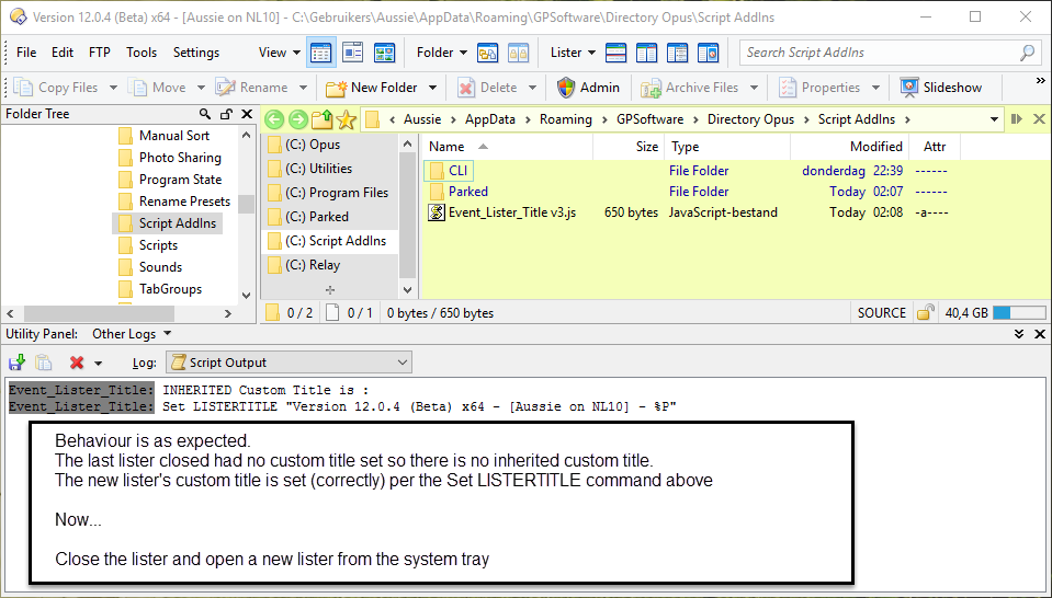

I start with a single lister and the only script that is active is the one listed above. I issue an immediate >Set LISTERTITLE= command to clear any custom title, then close the lister and exit Directory Opus via the context menu in the system tray. The "default" lister is thus set to the lister I just closed which has no custom title.
Now I open Directory Opus from the Start Menu. The "default" lister opens and the custom title is set correctly.

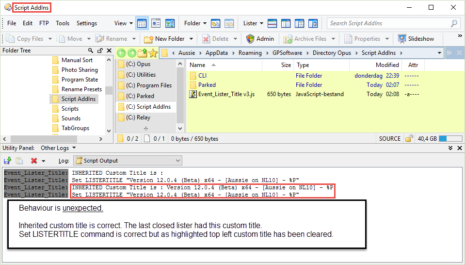

Now I close the lister and Open New Lister via the system tray context menu. The correct custom Set LISTERTITLE command is executed by the event handler but the result is that the custom title is cleared.
If I now repeat the last step, the custom title is created correctly every alternate time and cleared every other time. This is repeatable on my test system which is very close to a vanilla "as shipped" configuration.

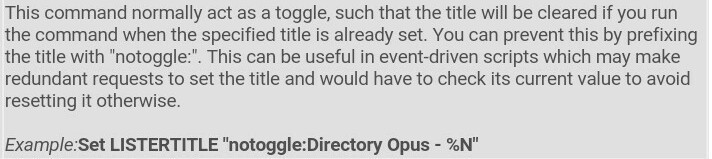

This is what you need:
Thanks Leo. As usual, it pays to read the manual carefully! All working now. Code as follows for anyone who is interested.
