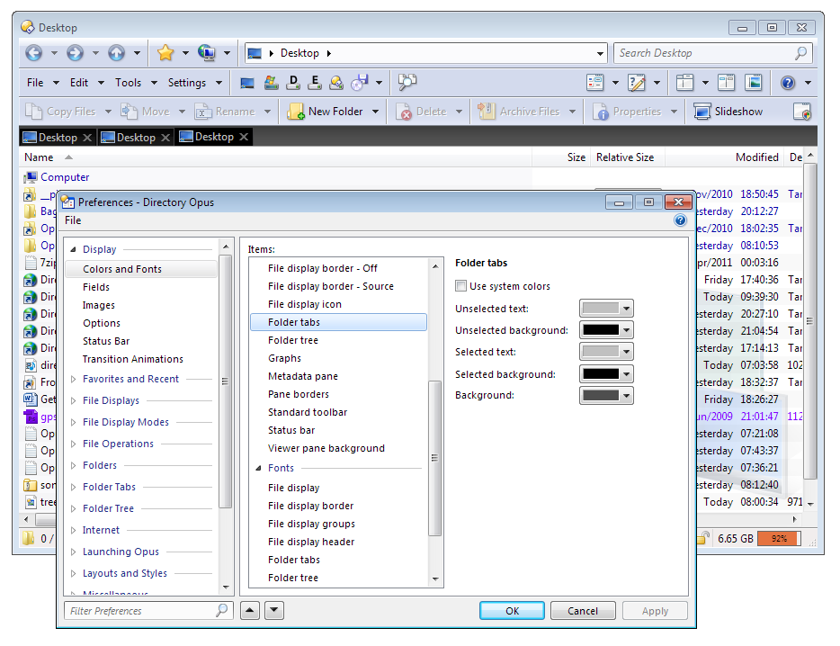

Can you all make me screenshots like the one below, showing the color settings for your tabs and what your tabs + toolbars etc. look like?
I think I can improve the re-coloring we do so it works better with darker colors but I want to check it against the real way you want to use it (e.g. to make sure the tab borders don't get blended into the background completely).

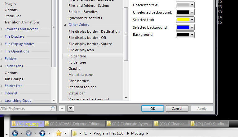

Here you have my foldertabs as they looked after upgrade to 10.
My settings from v9:
Unselected text: #c0c0c0 Unselected background: #000000 Selected text: #ffff00 Selected background: #0000ff Background: #000000
Those didn't look ideal then either, but it achieved its purpose (making them fit a bit better in the custom theme I used).

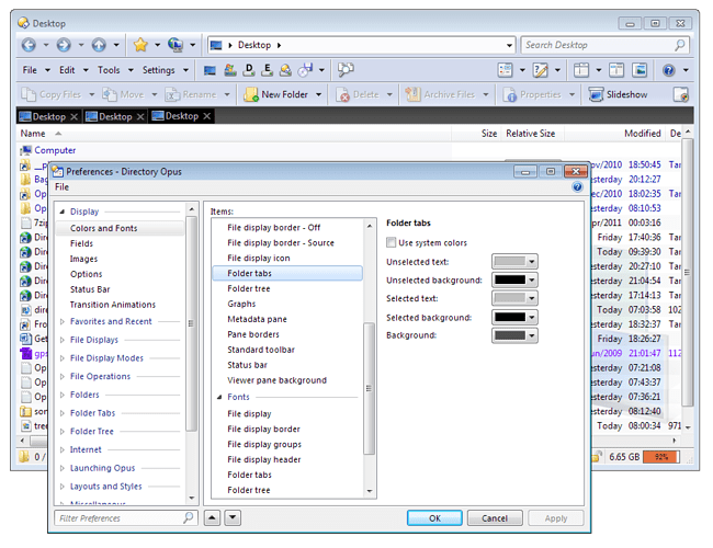

If I set "selected background" for the tree to black (i.e black selection background on black tree background), and fade enabled, and unfocus it, then it has a similar color as the unselected
color as the foldertabs I posted above.

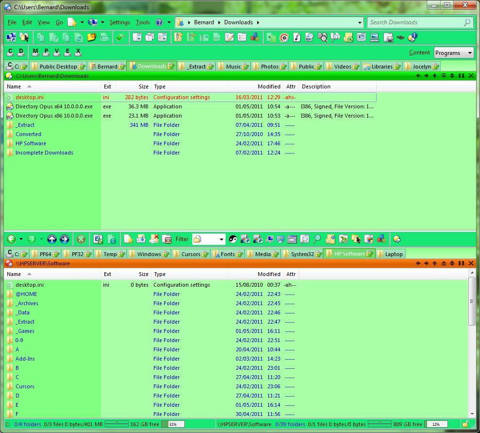

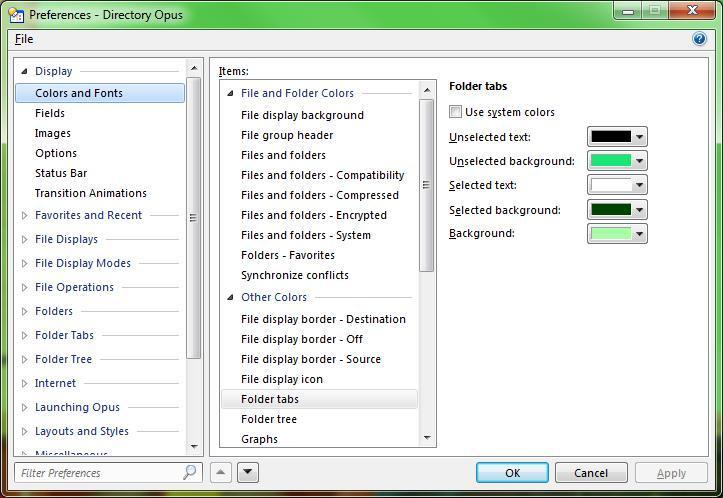

Here are my screenshots:
