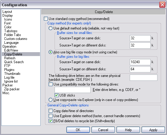

I tried the same with TotalCommander and it looks very similar (progress bar jumps and everything lags when browsing target device simultaneously). Than I check the preferences of TC and I change the copy mode from "default" to "big file mode" and I restart the copy operation. This time everything keeps responsible and the progress increases very linearly from left to right in 1% steps. I even can use DOpus to browse the target device while TC is copying in the background. By the way: TC looks like a seemingly dead dinosaur aside of DOpus on the same screen.
Maybe this will help fixing the problem!?
I do not know how TC exactly read/write the files in "big file mode" but it performs very nice even on systems having large memory available for file system caching. In addition I noticed that the "big file mode" appears to be slower for many thousands of small files than the default mode.
So if DOpus will provide an uncached copy operation too (hopefully) I suggest to introduce a configurable threshold. Files smaller than the threshold are copied cached and files larger than the threshold are copied uncached. I think this will provide the best of both worlds and even will outpace the current solutions provided by the competitors.
