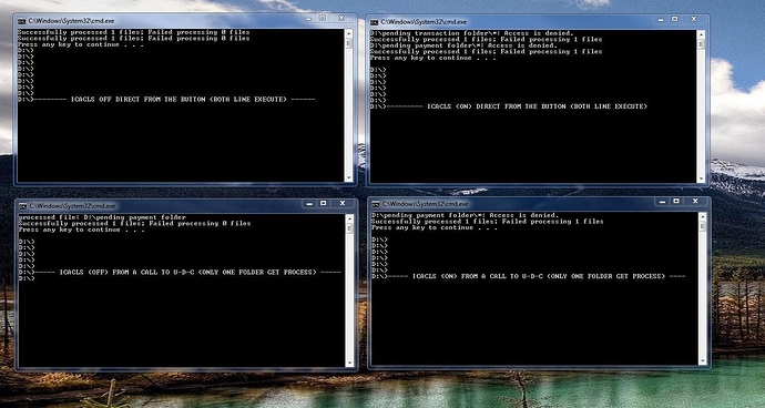

Hi Leo,
I have joined a Screen shot of some test result.
The JPG Image contain 4 CMD Windows.
The 2 at the top (left and right ) are for using the ICACLS line straight from the Button 2 time in a row (without calling the User defined Command (UDC)
The 2 at the Bottom (left and right ) are for using the ICACLS by calling from the Button the UDC 2 time in a row. :question:
As you can see, if the ICACLS is execute straight from the Button, bot directory get LOCK or Unlock.
But if I call the UDC (2 time in a row) from the Button, only the first line is execute (only one directory get Lock or Unlock). SO I can always use the ICACLS command line straight from the Button.
But is there a reason that if you call a User defined command 2 time in a row from a Button only one instance get executed. This would have to be check using a different UDC doing simple task and see
what happen if it is call 2 time in a row in a Button. Haven't try yet. Ran out of time.
We've looked into this in detail and found a bug where running the same user-defined command twice in one button would not work.
That should be fixed in the next update.
For now, you can either duplicate the command so you have two copies of it, or avoid using a user-defined command at all and put everything directly in the button.
