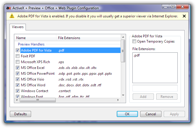

This warning is mean to appear if the Adobe PDF preview handler is turned on:
Afaik it is disabled by default and it displays the message you mentioned but due to this message I would not expect such problems.
So maybe the warning should be more detailed (is there a reason for this option?) or it should state that you do not recommand its usage.
Isn't the current warning enough of a dis-recommendation?
I don't want to remove the option to enable it completely as it's possible Adobe will improve their preview handler in the future. It's also possible that someone's Adobe Reader (etc.) may be broken and enabling the preview handler is better than nothing.

I have foxit installed but do not see Foxit Preview Handler as an available option. I have dopus 9.1.3.0
The FoxIt preview handler is a separate thing you can install in addition to the main FoxIt program.
You shouldn't normally need to install the preview handler to use FoxIt within Opus, since FoxIt should install itself as the PDF handler which Internet Explorer uses (and Opus views PDF files via IE by default).
If something else has taken over PDF in IE, you should be able to get FoxIt back by reinstalling FoxIt over the top of itself.
Still, if that doesn't work then the preview handler should work (and will also let you use FoxIt to view PDFs in Vista's Explorer and Office 2007).
