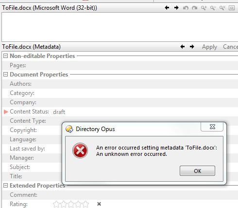

I was trying to set some metadata attributes programmatically, but wasn't getting any results, by which I mean nothing happened. At all.
For example, the following code below would give me a confirmation dialog, but it wouldn't change the properties.
Finally, just to see what would happen, I decided to change the properties manually...and received an error message (see image).
Please advise.
Thanks!
--sun

Does it work if you close the viewer pane?
No. I tried the code multiple times with the viewer pane closed, and that didn't work.
After setting it manually, I get an error as soon as I click Apply, so closing the viewer pane doesn't do me any good at that point.
Thanks, anyway.

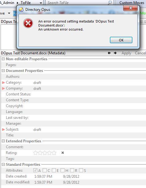

Does the error only occur with that particular document?
Are you able to change any of the other fields successfully?
Results with a different document are the same. First, I tried it with the metadata pane closed by default. Then I opened the metadata pane and tried to change several other properties (see image).
