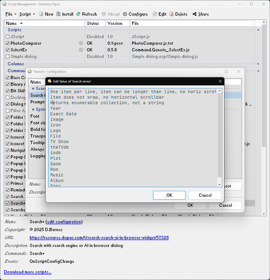

This is the config list control I am trying to replicate
That's just a multiline edit control, the only difference between it and what you can use in scripts is that it has a flag set on it to disable word wrapping. We can expose that for scripts easily enough.
