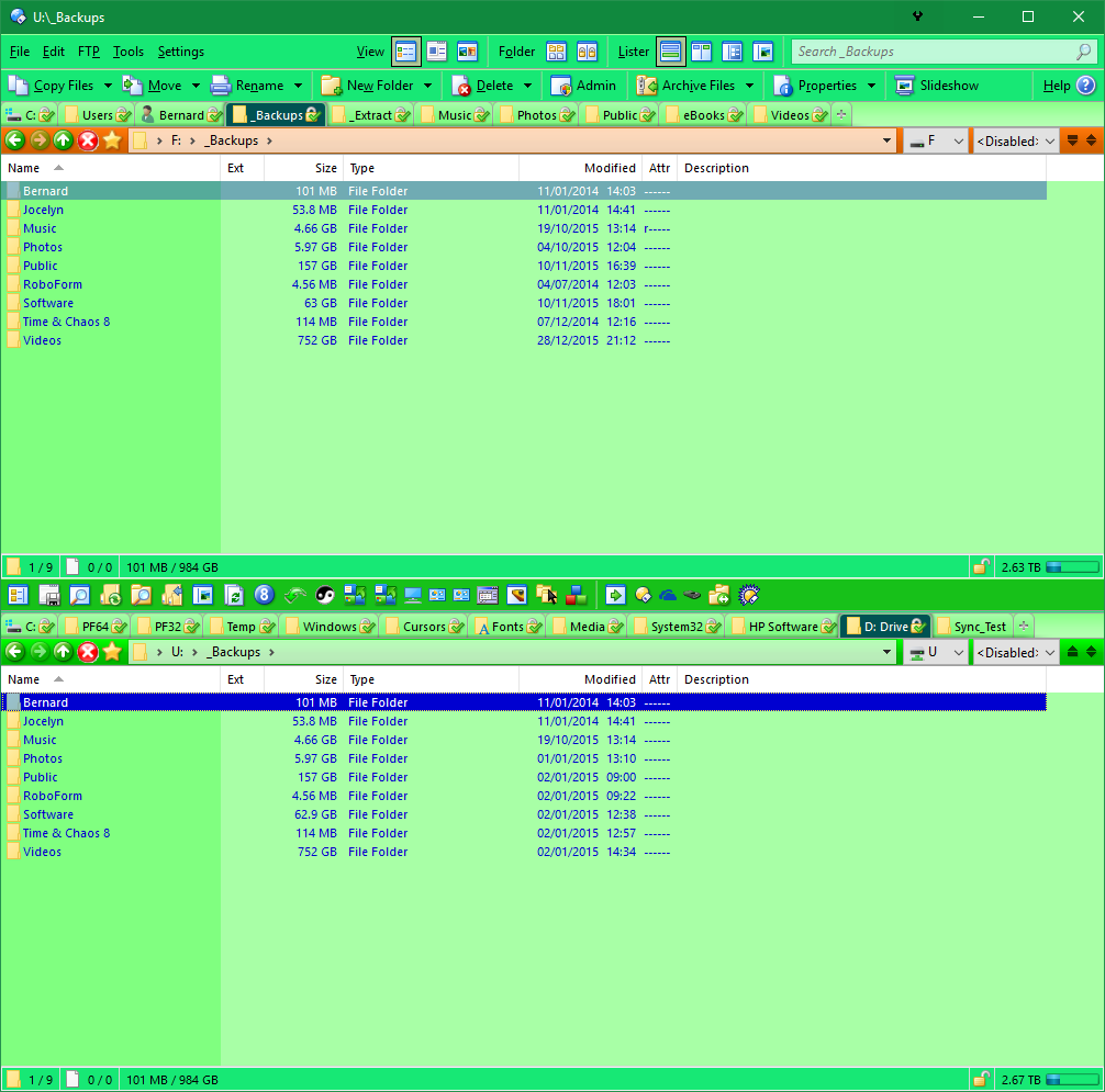

The drive complained of is my U:\ drive, shown here in this screenshot of Opus:
I am trying to sync U:_Backups to F:_Backups, shown in the upper panel of the Opus window.
