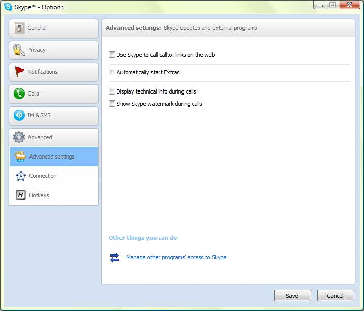

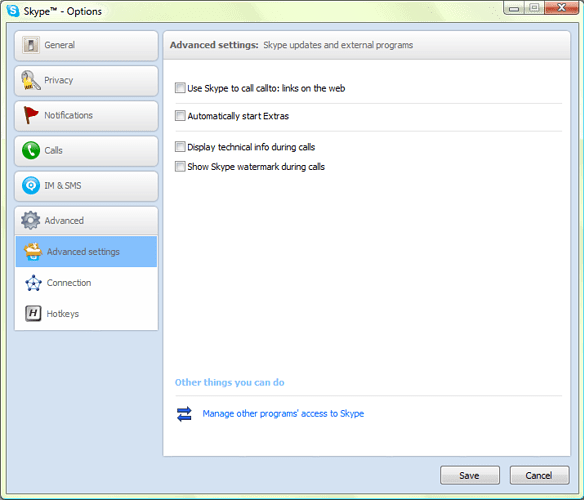

Where is this option? I can't find it.
[quote="Scred"]
Where is this option? I can't find it.[/quote]
Tools|Options|Advanced: "Keep Skype in the Taskbar while I'm signed in" <= I unchecked this
My version of Skype does not have that option.
Are you using the business version of Skype ?
[quote="Scred"]My version of Skype does not have that option.
Are you using the business version of Skype ?[/quote]
No, just v. 5.1.0.112 (on WIN7 64 bit). The option is in-between your 3rd and 4th option (I have 5 options)

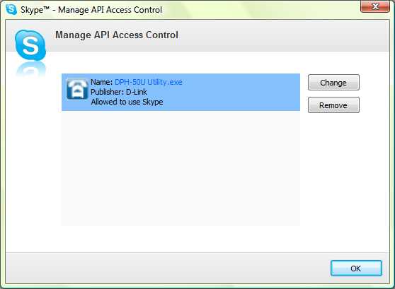

One more thing that may ( or may not ) help GPsoft define this problem is your settings under the link on that page "Manage other programs' access to Skype'' .
I have ony my D-Link VOIP Adapter listed.
