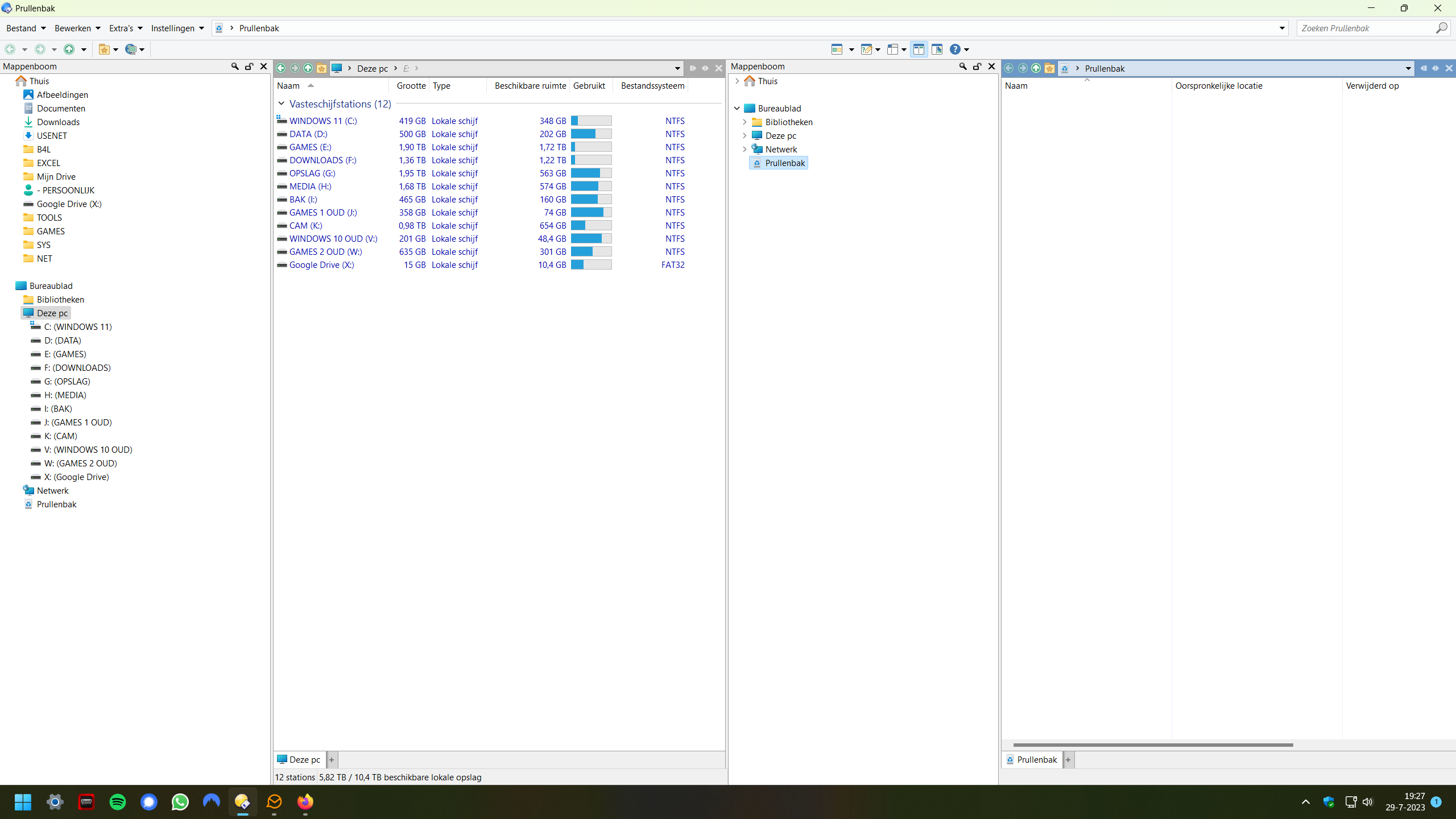

If you right-click the Up/Parent button, there's an option to go to the Recycle Bin in there:
Does that work when you use it? What does the Folder Tree do when you go there?
Which option do mean when you say the Recycle Bin was hidden in File Explorer? Have you tried rebooting after changing it?
That does work. Bin is now added as last item in the tree. Not default I guess, as I had to do the same trick for the other tree (I always use 2 windows pane vertical). But after saving this setup as the default lister it sticks, also after rebooting Windows.

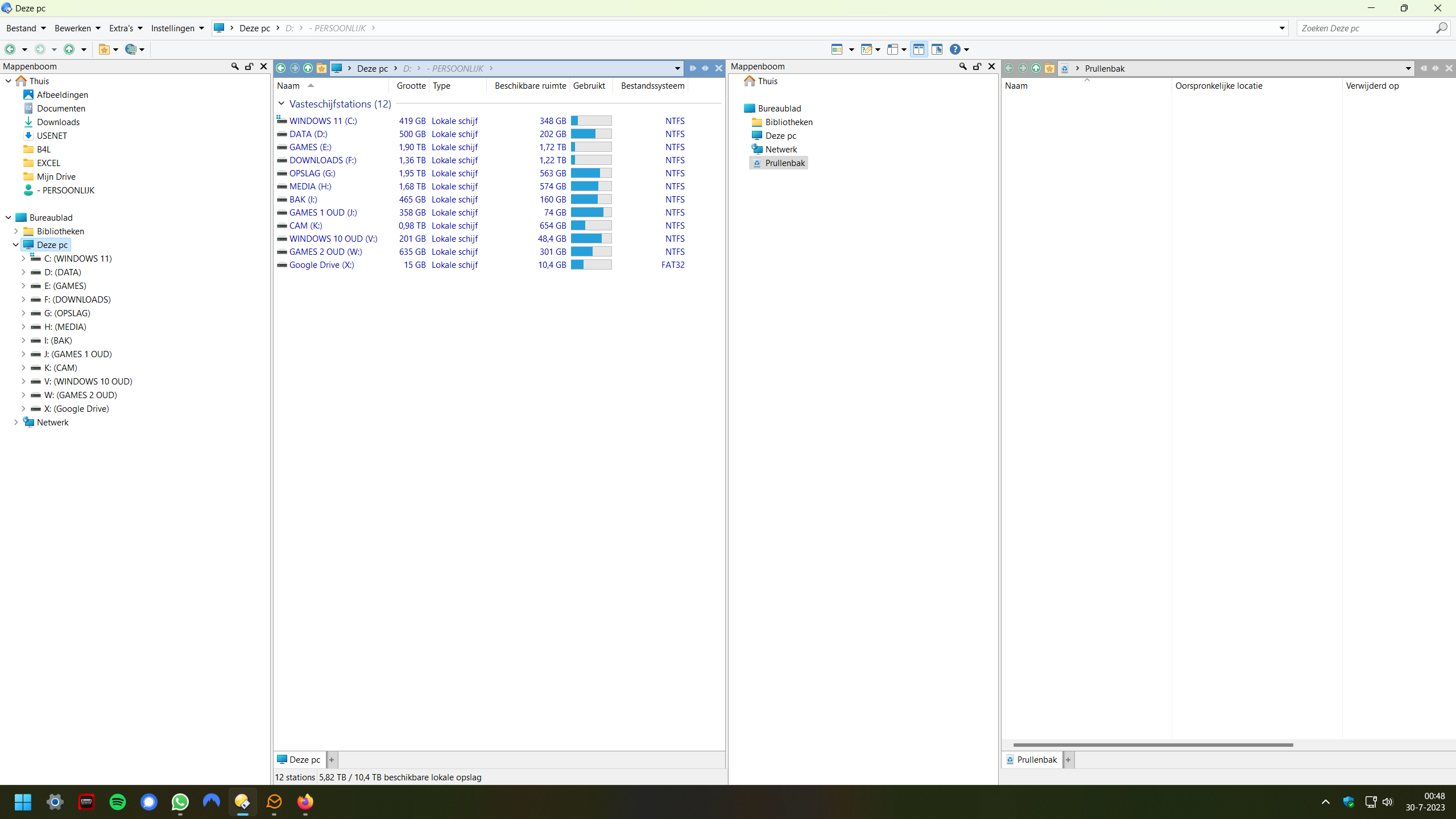

Could you show a screenshot of what your tree looks like in Opus?
Next time it disappears, please take a screenshot so we can see what's going on then.
Okay, like this then: first screenshot shows left bin is gone again, refreshing does not help. Second screenshot right bin is gone too, right after clicking on a random visible folder and then refreshing.

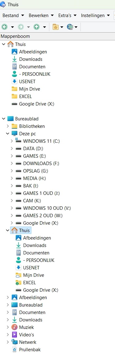

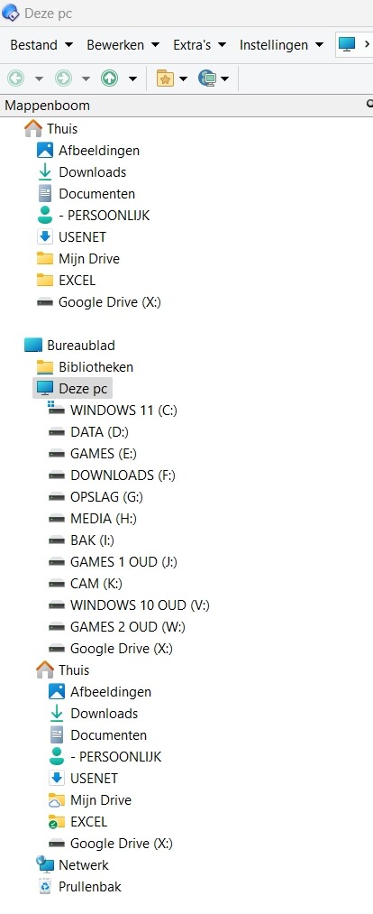

Okay, reinstalling did the trick. Still one issue left: I am seeing the 'Thuis' (apparently the Dutch translation for 'Quick access') folder twice in my tree. That's annoying and also not handy.
The only way to get rid of the second one seems to be turning 'Virtual (non-filesystem) folders' off, which is not handy off course, as I will then again lose my Recycle bin.
In Windows File Explorer this folder is only present once, at the top of the tree. Why do I see it twice in Dopus and is there something I can do about it?
I'm not sure why that would happen, unless something unusual was set in the registry to add Quick Access as a folder under Desktop, perhaps.

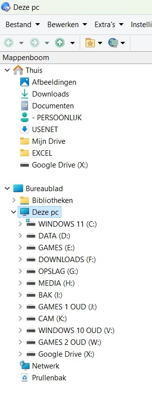

Ok, found the culprit! All my bad I'm afraid, my apologies. I discovered I adjusted all entry's in the register earlier, except the last one.
Now it looks like this:
2023-08-03 19 22 39
And Dopus like this:
So I am very satisfied, this was the desired outcome.
