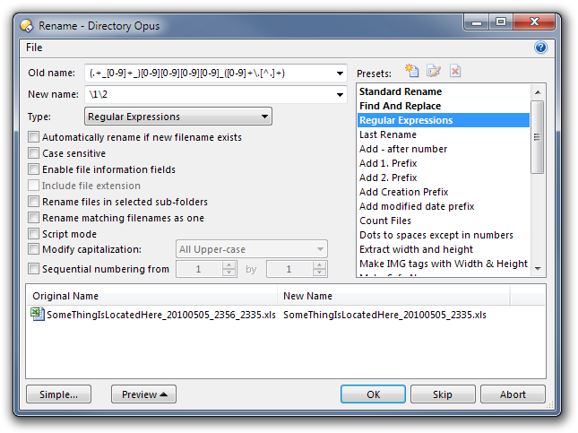

Old name: (.+[0-9]+ )[0-9][0-9][0-9][0-9]_([0-9]+.[^.]+)
New name: \1\2
Type: Regular Expressions

worked fine, thank you again
