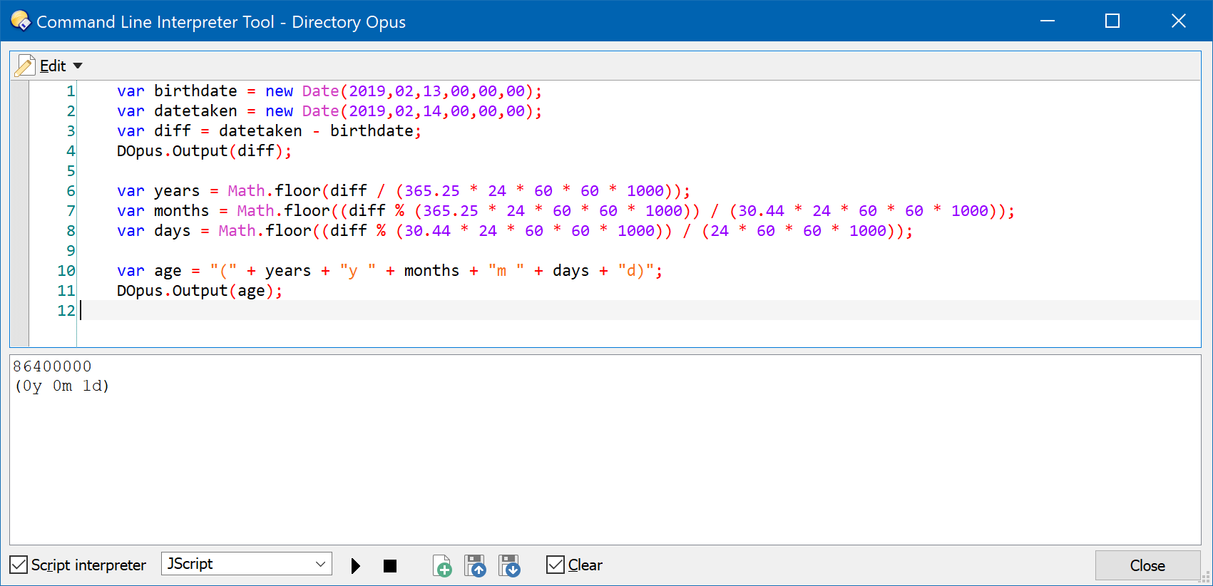

Thanks @Jon, so I don't know why my result with negative values
Correct result with JScript in Opus as well, when using two hardcoded dates:

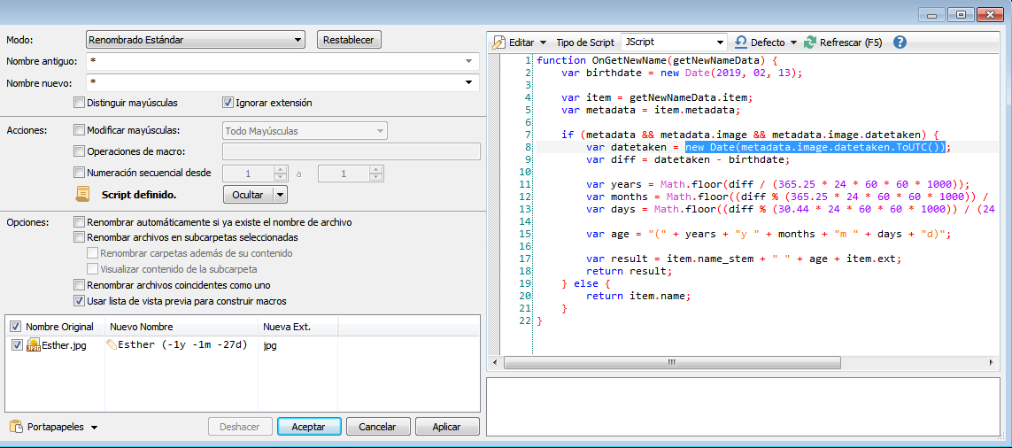

My bet is it's a timezone/UTC issue.
Try changing new Date(metadata.image.datetaken) to one of these. If one works, the other should make it worse. If both seem to work (or both make it worse) then I might be wrong about it being timezone related.
  • new Date(metadata.image.datetaken.FromUTC())
  • new Date(metadata.image.datetaken.ToUTC())
Edit: You could also use Opus's own Date object, instead of the JScripts ones. That should avoid the issue as you'd no longer be mixing the two objects together, and you can compare the y/m/d values separately without all the extra math:
https://www.gpsoft.com.au/help/opus12/index.html#!Documents/Scripting/Date.htm
I tried the 3 recommended ways and the result is still the same.

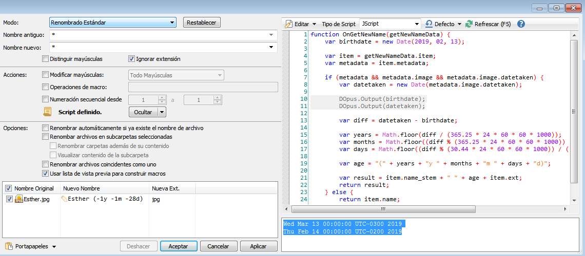

But, taking a step back, what are the dates if you output them?
In other words:
DOpus.Output(datetaken);
DOpus.Output(birthdate);
Presumably one of those is not the expected value.

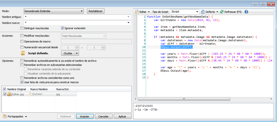

True Leo, I simply used DOpus.Output from what I saw, I know practically nothing programming

What do you get if you output the two dates like I asked just above?
Sorry, I did not understand. You recommend me to do what with:
I inserted the lines in the code and the two dates with different UTC are displayed, and the month of birth in 3 when it should be 2, as said @bytespiller.
The JScript Date month values are in range 0-11 (and not 1-12 as you would expect, so the month value 0 means January and the month value 11 means December).
To fix this, simply put the birthdate as: var birthdate = new Date(2019,01,13); or if you prefer: var birthdate = new Date(2019,02-1,13);
