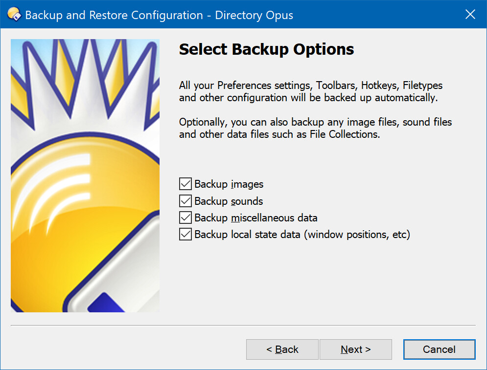

Any installed Icon Sets should be backed up, at least assuming all the options here were on:
(Edit: Same for things in the Script AddIns folder.)
The .ocb backups are really .zip archives, so you can rename them and look inside to see exactly what was included. The icon sets would normally be .dis files within the Icons sub-dir.

When I imported the icon set, my tool bars updated to the new icon, except for a couple of buttons. I changed these and saved the toolbars, and even made a toolbar set. I backed up with same settings you posted, and imported all except for the "replace" option on the import. Is that where I am going wrong?
The "Replace entire config" option, when importing the backup, will overwrite everything as well as remove any config files that no longer exist in the backup.

Make sure your are selecting all the categories when doing the backup and restore.
