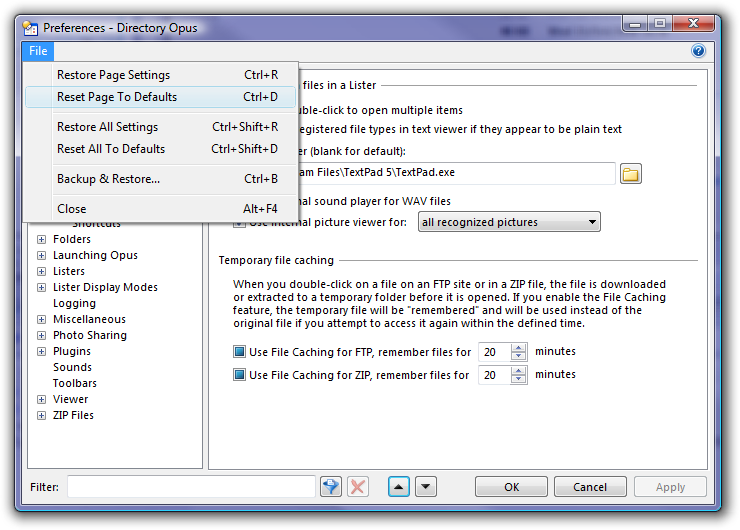

You can reset Preferences to the defaults using the File menu in the Preferences window. There is a menu item to reset the current page to defaults and another item to reset all of Preferences to defaults.
The main ListerMenu and Toolbar toolbars can be reset by deleting them and restarting Opus.
To reset those settings and all others (e.g. File Types and all the other toolbars), uninstall Opus (which will delete your config) and then reinstall it.
:sunglasses: TAXI!... An ophthalmologist Please! :sunglasses:
Your mentioned menu was invisible for me to now :laughing: Thanks for your very useful information just as always. :wink:
