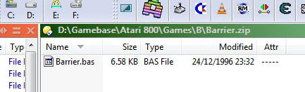

If I try and find an extension type that I know is inside a zip file(s) I'm getting zero results but if previously I've looked inside the file with Opus then it finds it ie it's finding it via a temp in memory.

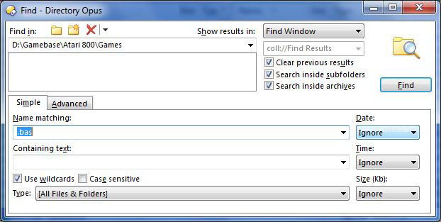

I've checked the Find window, it's set for files and folders, none of the ignores are set to anything. Clear previous results, search inside sub folders and archives are ticked.
I have made sure it's not looking for text inside..
I've tried .bas and *.bas to check for inside the zip files and I get zero results. I'm 100% sure this worked as stated before?

Can you show us a screenshot with the setup of your Find panel/window, and also Opus showing the items you expect it to find inside the zip file?

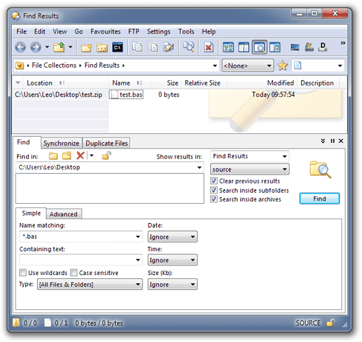

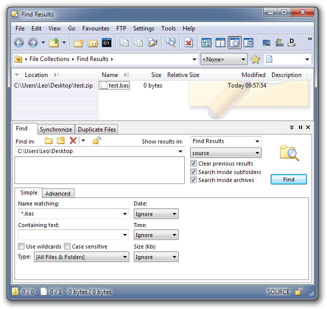

I tried with a zip I made myself and it seems fine:

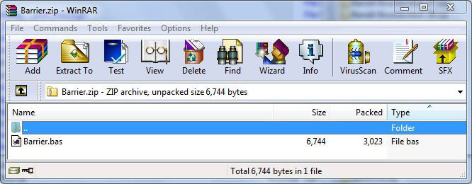

BTW, I don't think you've posted one of the zips yet, in case it's something special about the zip files themselves. Post one if you want us to check that we can search within them on our machines.
