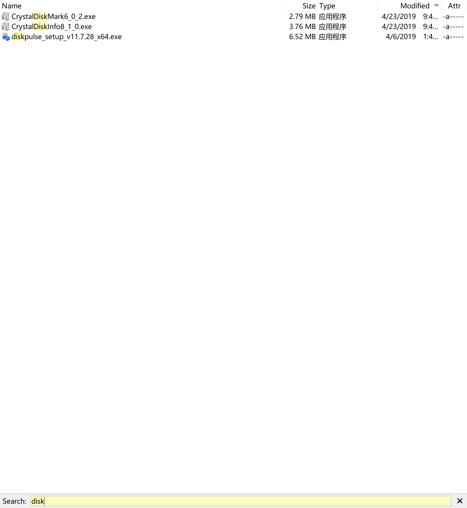

How can I use Find mode, hide any files that don't match, and the highlight text does not disappear? like this:
You should be right, not so much different from the version, but rather the difference between Search and Find.
BTW, Search mode has a unique advantage, can search for text content, which is not available in Find mode, it is too useful.

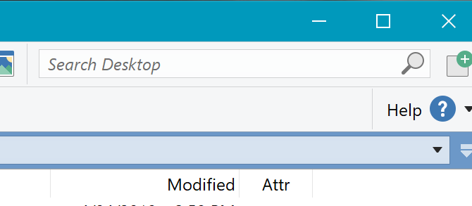

The two modes are quite different.
Search mode is the equivalent of running a search from the toolbar field at the top-right of the window:

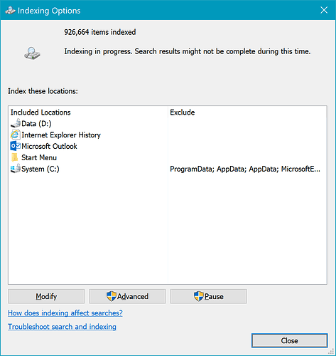

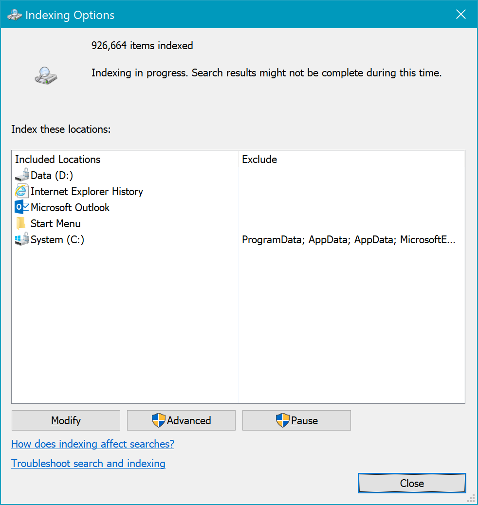

That's right, Search mode is more suitable for me, but it seems that Search mode is not stable. After I restored the system, the file name and content could not be found. It will take a while to work properly.
It uses Windows Search, which may need to rebuild its index after a system restore. You can see the indexing progress in the system Indexing Options dialog.

No matter how I set it up, I can't just type disk
to find CrystalDiskInfo8_1_0.exe
in Search mode, which doesn't seem quite normal.
I think that's just how Windows Search works, at least for filenames - it seems to only match the beginning of the names by default. If you type *disk
it finds both.
You are right, Windows Explorer is also the result. Type *
to first call out the filter, I can only type disk
first, then type *
at the beginning, and there is no highlighted disk
in the file name.
