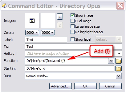

Next with Opus in customize mode, drag that text file you made to a toolbar somewhere then edit it and add a {f} at the end of it like indicated in the screen grab below.
Then exit customize mode and see how it works for you. If all works as it should you can edit the Opus button again and add RunMode Hide to avoid the DOS box.
