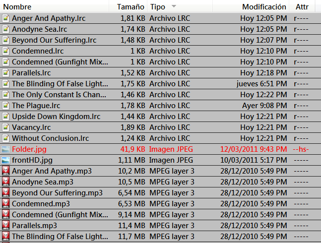

I save my music in folders ordered by artist\album, in conjunction with the lyrics (lrc files) and the covers (jpg files). What I wanna to do is set the audio files (mp3,wma,flac) read-only, and the lrc and jpg files set off the read-only attribute.
I tried creating filters such:Name coincide with *.lrc and ATTR read-only is on and the button:
SetAttr CLEARATTR=r FILTER=Lyrics RECURSE
just to try in the lrc files in first place, but it doesn't work.
What I'm doing wrong?

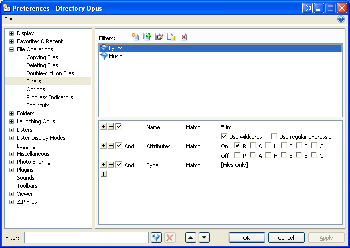

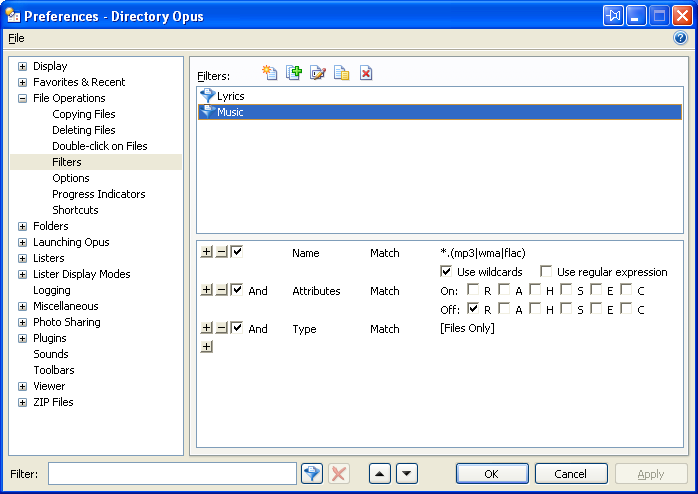

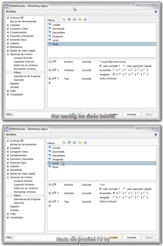

I created two filters; Lyrics:
and Music:

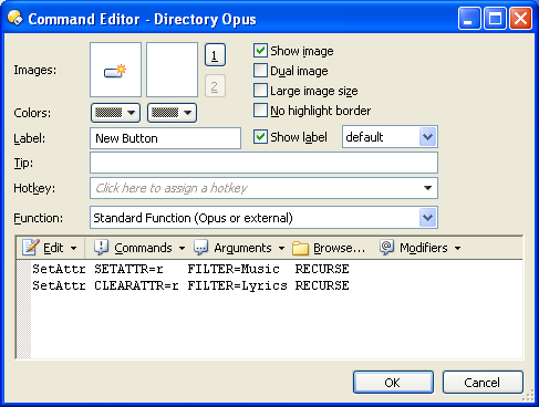

Then I created a button which ran this:
SetAttr SETATTR=r FILTER=Music RECURSE SetAttr CLEARATTR=r FILTER=Lyrics RECURSE
If I select some folders and click the button, it clears the R attribute on *.lrc and sets it on *.(mp3|wma|flac)

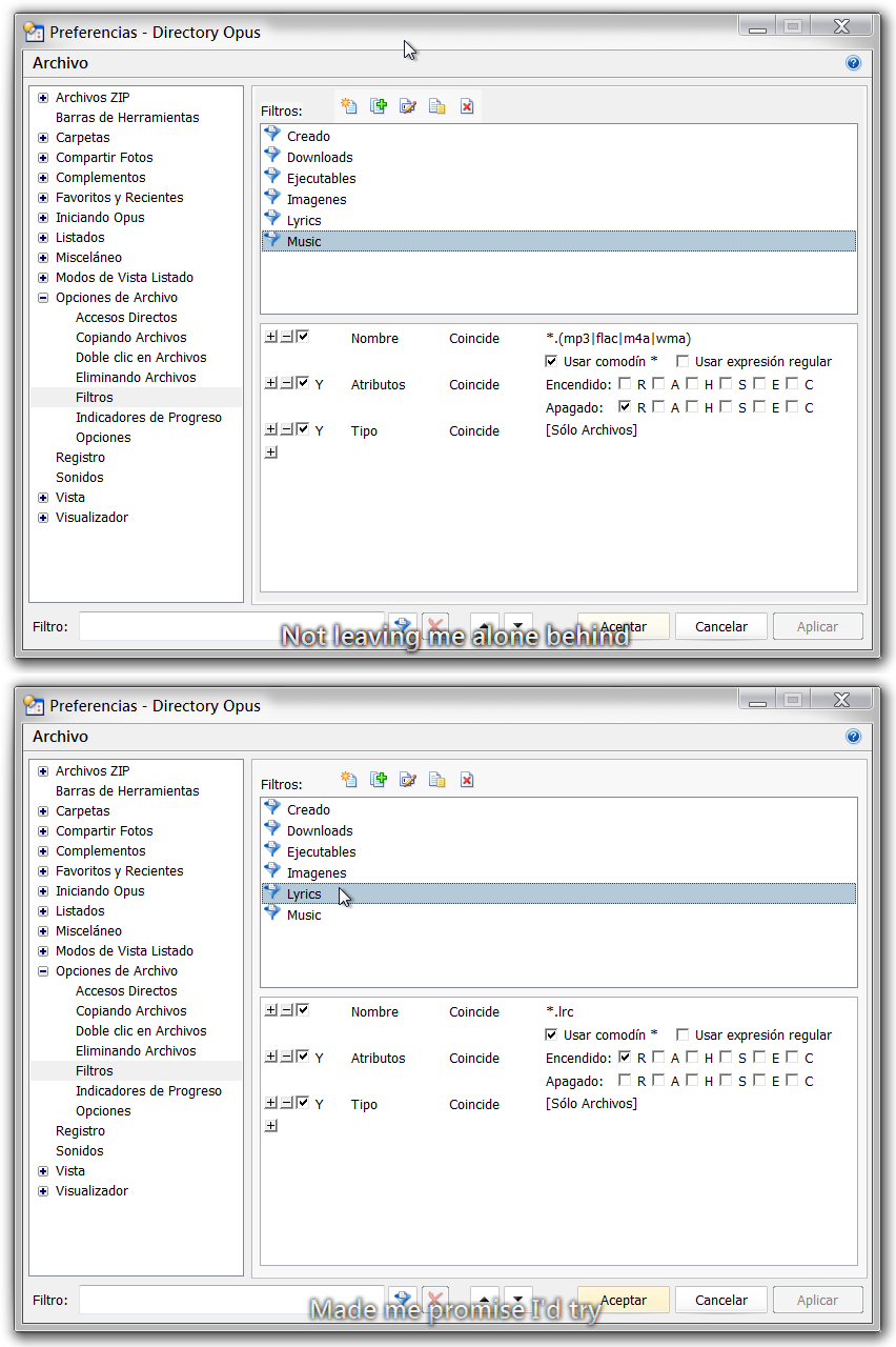

I created the same filters:
Lyrics
and Music:

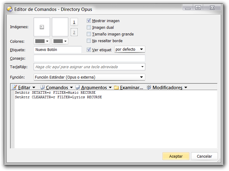

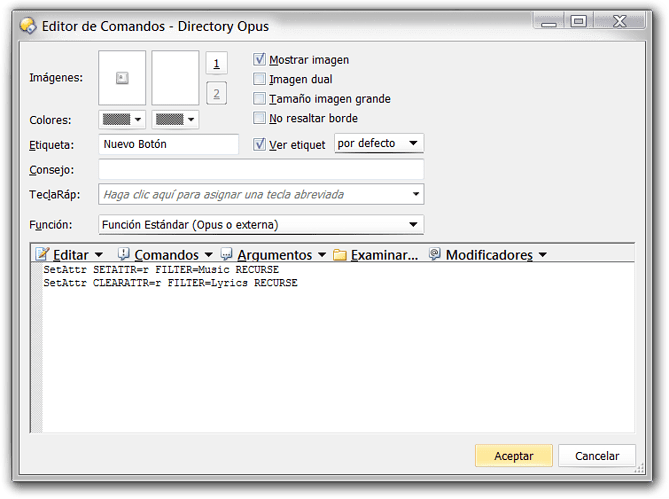

and the same button code:

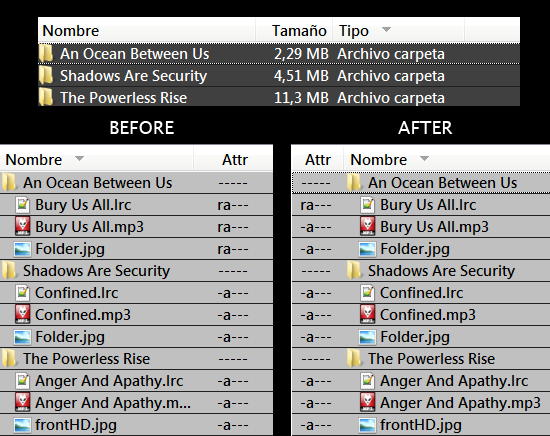

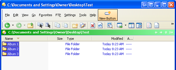

I've checked on a vanilla install and it seems to work fine. Here is exactly what I am doing...
I created three test folders, with only the files in the first folder all set read-only to start with:
I created these two filters:
I created this button:
Then I selected the folders and clicked the button:
Here is the result, with the original attributes (from the first screenshot) next to the new ones for easy comparison:
I don't understand, I'm doing exactly the same. Every step. But doesn't work.
The mp3|flac|wma files are set to not read-only (no matter the original attribute), and the lrc doesn't change.

Look. The filters.
The button:
Then I select the test folders and run the button, and this happens:
