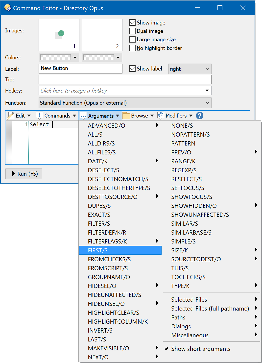

I don't have Select First in the list of the functions. (see attached file).

That dropdown only lists the most common commands. There are thousands more possibilities, which can be typed in. You can also click Advanced and then use the menus at the top of the command editor to build up more complex commands.
If you want to change the keyboard focus as well as select the first file:
Select FIRST
Set FOCUS=Source
(You'll need to click Advanced in the button editor to enter a two-line command.)
Or you may just want Set FOCUS=Source if all you care about is the keyboard focus. But also note that you can just push return after typing a pattern in to the filter to do the same thing; it doesn't need a special command.
