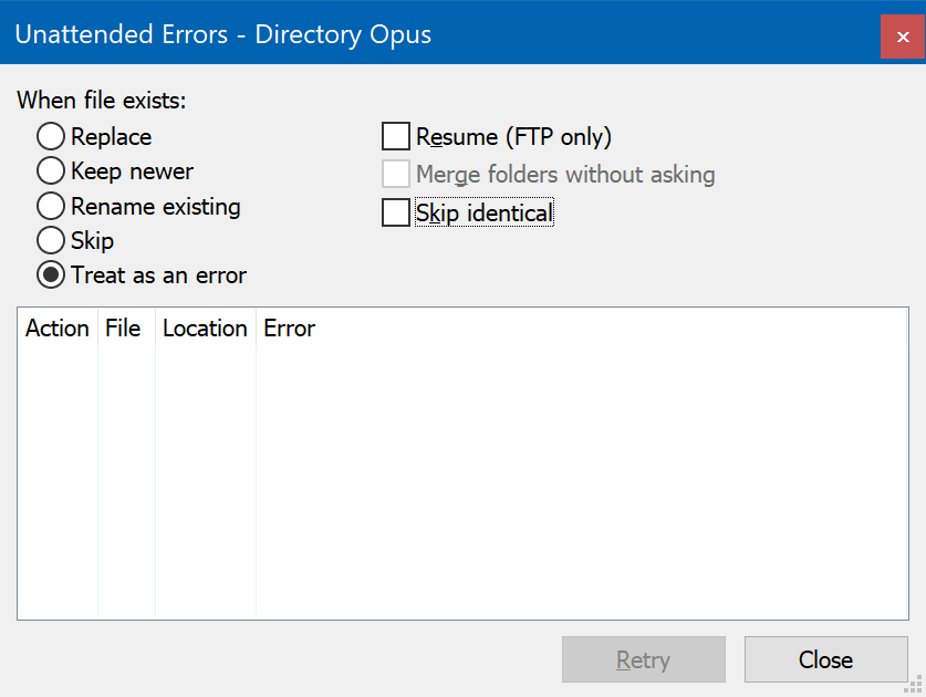

Which "Skip Identical" did you use, out of interest...
The one in the Replace dialog?
Or was the copy done in Unattended Mode?
