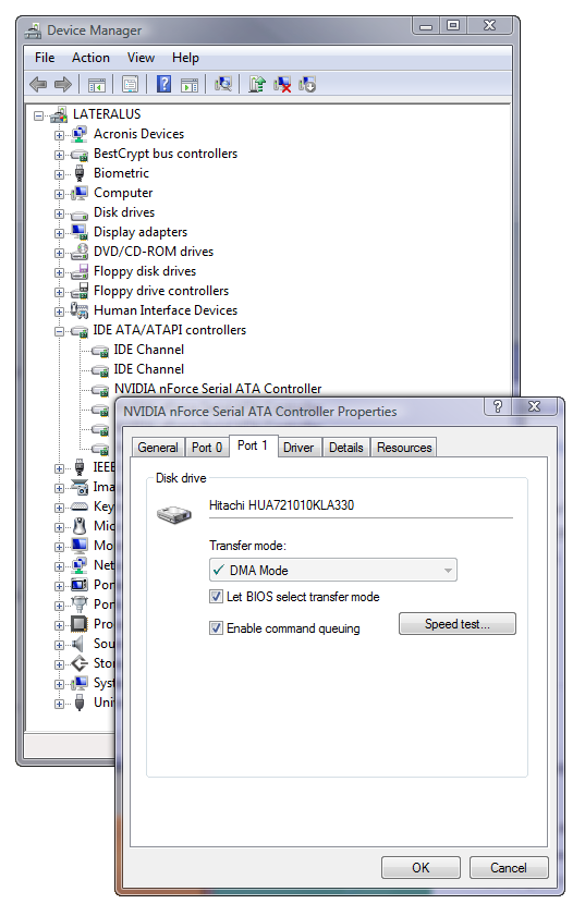

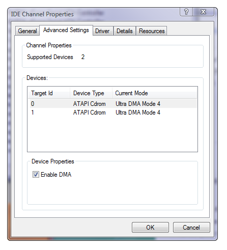

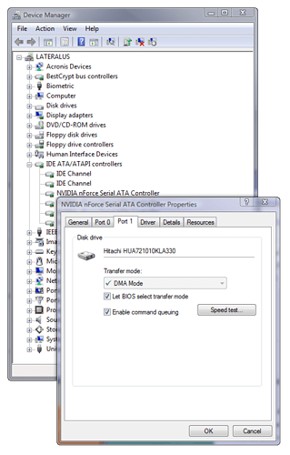

Another possibility, especially if the slowdown started after adding a new drive, is that one of the drives is not in DMA mode and is using the CPU to move data around instead. To check that, go to Device Manager and open properties for all of your IDE ATA/ATAPI Controllers and see what they're set to. Below is a screenshot showing one of my HDDs and two of my DVD-ROM drives, all with DMA enabled. If you see anything about PIO then that could be the problem.
(I wouldn't worry so much if you have optical drives using PIO, unless the slowness only happens when they're in use.)
While you're in Device Manager, open the Disk Drives section and bring up properties for each of your drives. See if anything looks wrong in their tabs (but don't change anything if you're unsure what it means).
