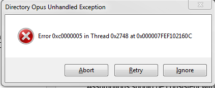

FYI... I just checked and DO is running at 25% CPU. I had been browsing in thumbnail mode but DO was its typical < 1%. Not sure when the CPU ramped up. High CPU when using thumbnails is nothing new, or a result of your "trick". It has been doing that for some time, as I believe you noted in one of your earlier posts. Below is the dopus error dialog I got when I exited the app.
So here is a new SW problem that the DOPUS folks can amuse themselves with now that the old is fixed! Ha... just kidding. I do like browsing in thumbnail mode myself though, so it would be great if the error below gives you guys any clues.
