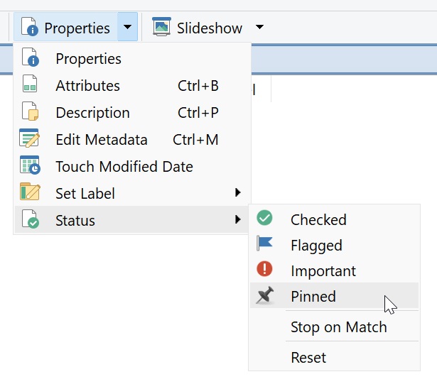

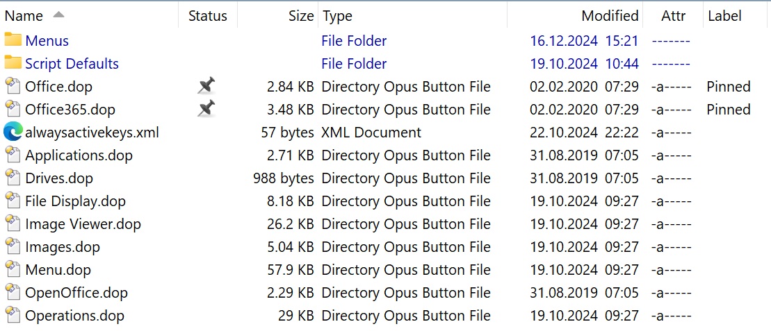

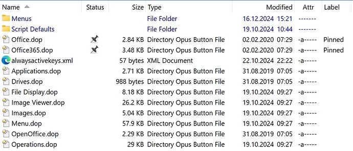

Files with the Label/Status Pinned will be automatically shown at the top of the file display. This feature was already available in Opus 12.
