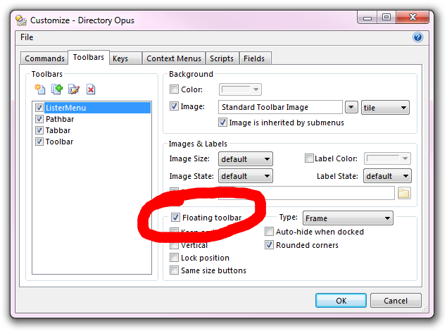

It sounds like you have just accidentally floated the menu toolbar by dragging it out of the Lister. The easiest way to fix it is to go to Settings / Customize, and turn off the Floating Toolbar option (see image below.)
When a toolbar is floating any hotkeys assigned to that toolbar become global - this is why you've lost Ctrl-D in other programs, but as soon as you unfloat the toolbar this problem will be solved.
You can also lock the toolbars (right-click on an empty space on the toolbar and choose the Lock option) to prevent accidentally dragging it out in the future.
