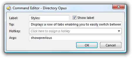

Edit the styles tab and add the showprevious arg.
Thanks a lot Steve, works perfect!
