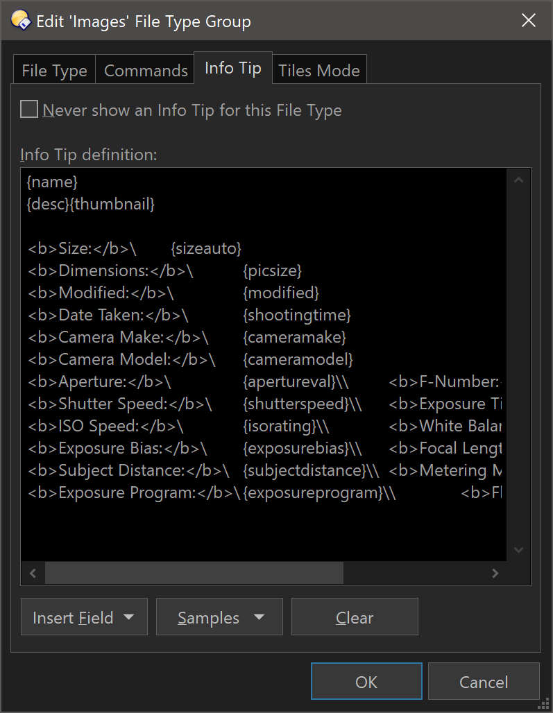

You don't actually need <br> tags for new lines in info tips. A normal blank line is enough.
The default Images into-tip, for example:
They let you display date as a table (rows and columns).
I've added them to the Into Tip documentation, near the bottom. (Previously, they were only documented in the release notes.)
