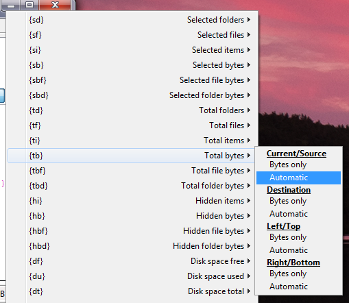

I think this code is the one you want from the menu?
If you select that, you get {tba} not {tbda}.
