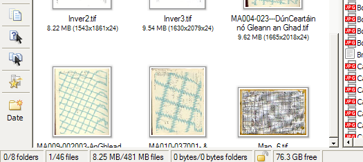

Text of lowest thumbnails cut off
XP SP2 (otherwise uptodate) Fresh install of ver.9 (on top of ver.8, settings imported)
The Problem is:
See below how the text below the bottom thumbnails is cut off even though I'm scrolled down as far as I can go
Just noticed:
when I select the file, the thumbnail shifts up so I can see it's name etc.
when I deselect the file, I can still scroll down & see the text.
But if I select a file above the bottom row, I can again no longer see the text of lowest thumbnails.

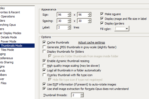

Please post a screenshots of Settings -> Preferences -> Lister Display Modes -> Thumbnails Mode.
Also, still in the Preferences window, go to Display -> Colors & Fonts, expand the Fonts part of the list and tell us what's set for the File display and the Thumbnail labels fonts.
(If you see anything that looks wrong in either place, please take a screenshot before changing it, that way if you change the setting and find it fixes things for you we can still investigate it further and ensure it doesn't go wrong for anyone else.)

I can reproduce the problem now and I've sent a bug report to GPSoftware about it.
You can fix things by changing the second Spacing value (currently 30) to a smaller number, e.g. 5. Seems that large vertical spacing values are causing Opus to incorrectly calculate the height of the last row of thumbnails.
no, Thank YOU Leo!
I dont know had I changed that setting since the upgrade (didnt think so, otherwise I would have tried changing it back). Even a setting of 20 corrects the problem
Many thanks again for your help and for reporting it
