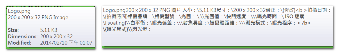

The format of infotips is incorrect in Chinese Traditional
The format of infotips is incorrect for some file types (.exe and images files) in Chinese Traditional. DO v13.6
Thanks. Fixed in next update.
This issue still remains in v13.7
You may need to reset your info-tip to pick up the new defaults.
  • Settings > File Types > File Type Groups > Images
On the Info-Tip tab, click Samples at the bottom and choose Images.
(If you haven't modified the File Type Group, e.g. to add context menu items to it, then you can also right-click the group itself for an option to reset the whole thing.)
