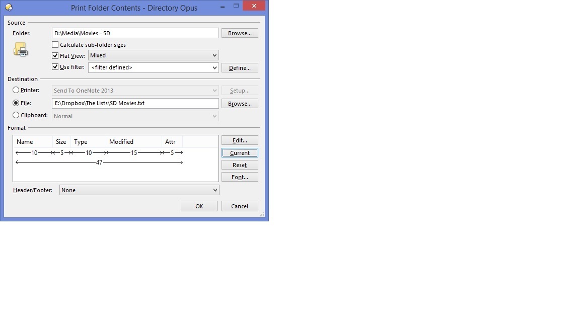

Can you post a screenshot of the Print/Export Folder window so we can see how it is set up?
If the list is blank you may have a filter set that's excluding everything.
This is the root folder...
This is the folders I want listed...
D.O. configuration..

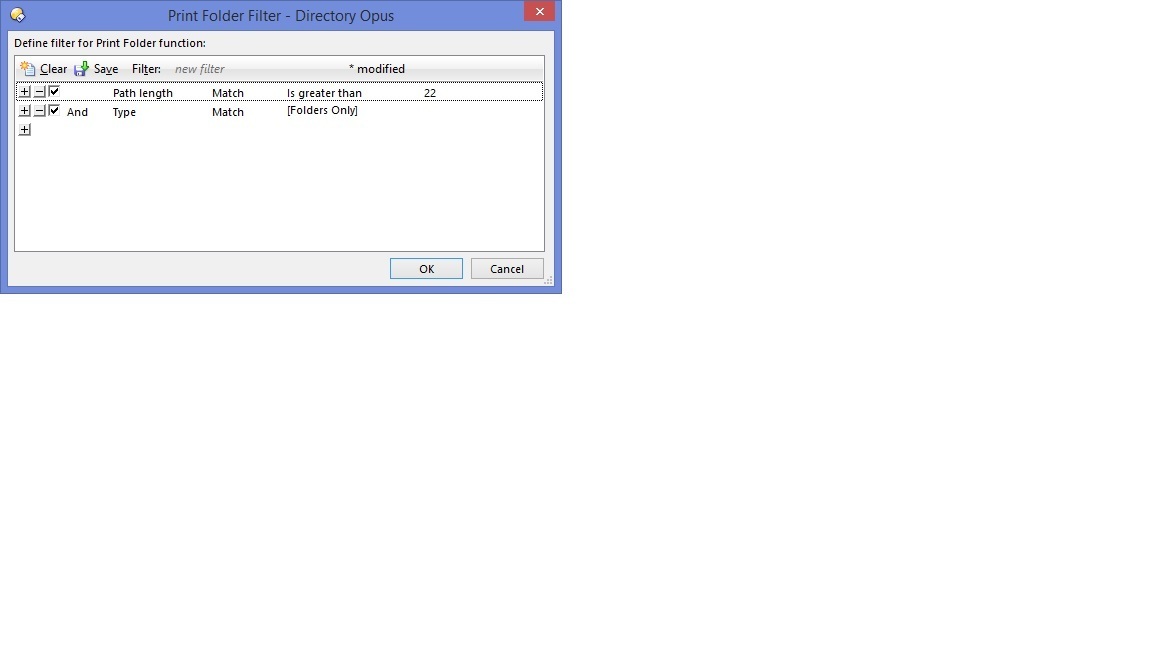

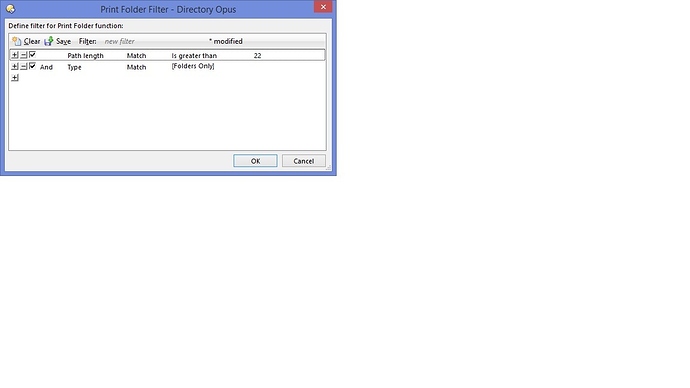

And the filters...
I'd say its the path length restriction that's to blame - try taking that out.
If I take out the path length restriction, how do I get it to only list the subfolders???
Try disabling the filter just to find out if it is what's making the list blank. (Disable the whole thing, and then if that work, turn it on again and disable the individual clauses for two more tests, to find out which of the two clauses is causing the problem.)
If it is the filter, we can then work out why it is doing that.
If it isn't the filter, then we know to look at other things and not waste time on the filter.
It's the filter, I've tested it like mad.
the path length to the sub folders, D:\Media\Movies - SD\ is 21 characters...
If I set the filter to 22 or greater, I get every folder below it...
if I set the filter to 23 or greater, I get nothing...
