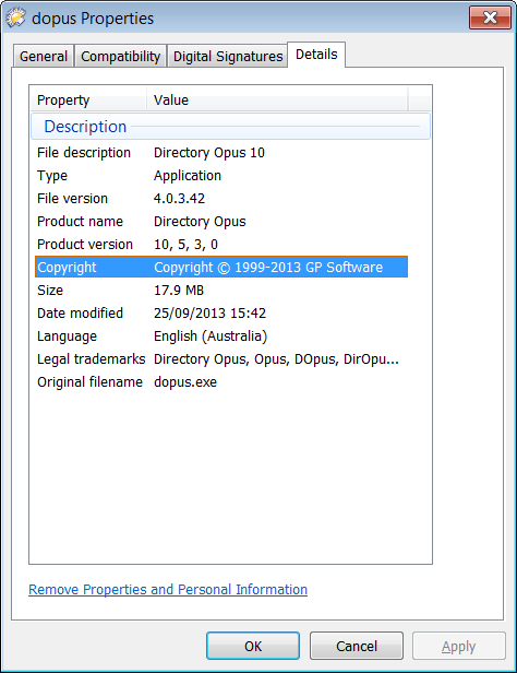

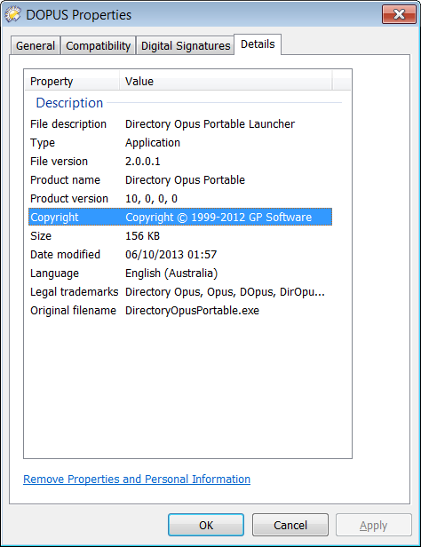

I've just noticed that I've got a DOPUS.exe file in the root folder, plus another one in the O:\DOPUS\ folder. Is this correct?
The properties are shown below...
Yes, they're both needed and different to each other.
