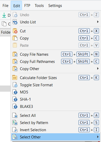

Problem is I don’t have any of that. On the Edit menu I still only have the original MD5, SHA-1 and BLAKE3 checksums, plus I do not have a Calculate Checksums sub-menu.

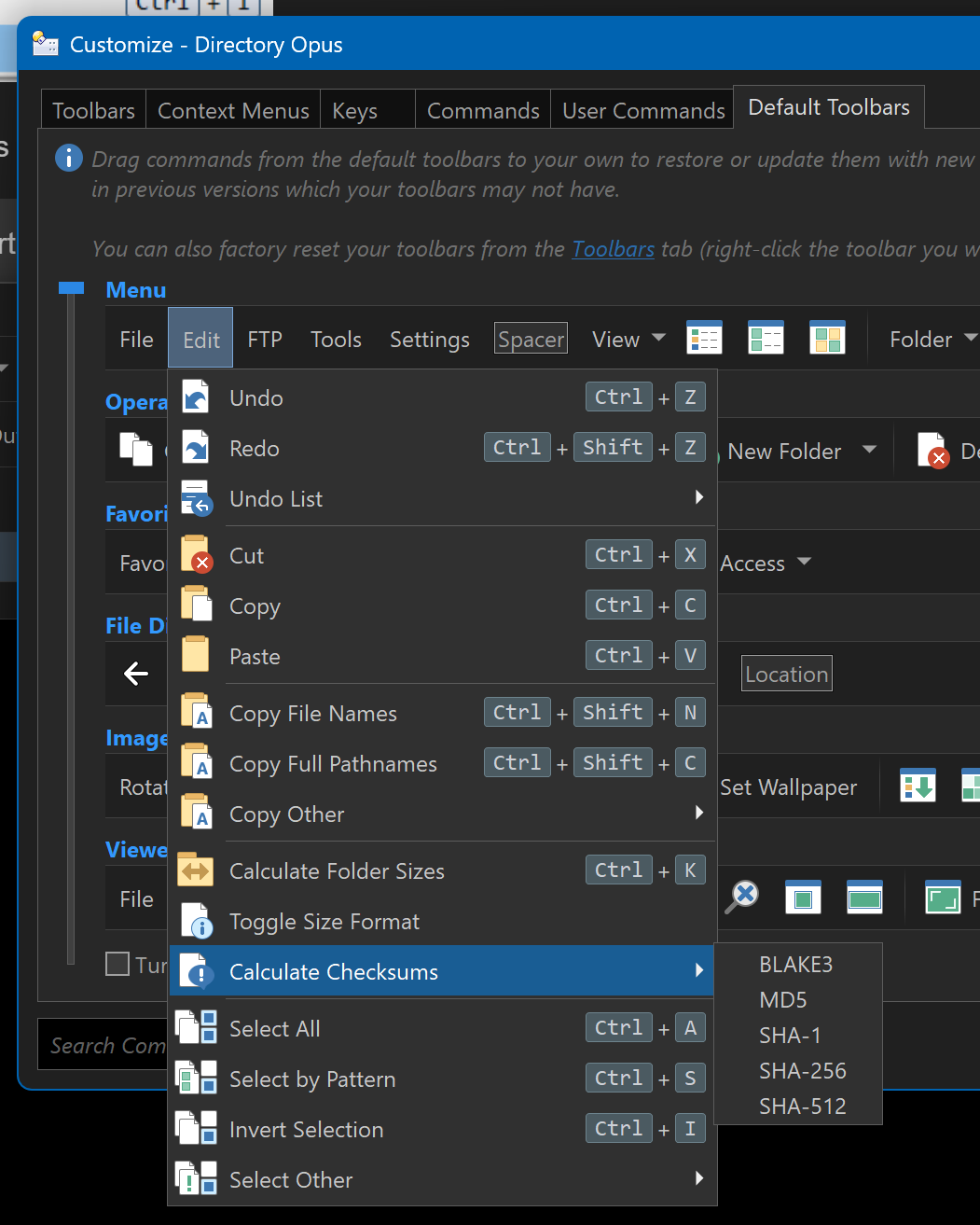

You need to reset Menu toolbar (but you loose your customisation).

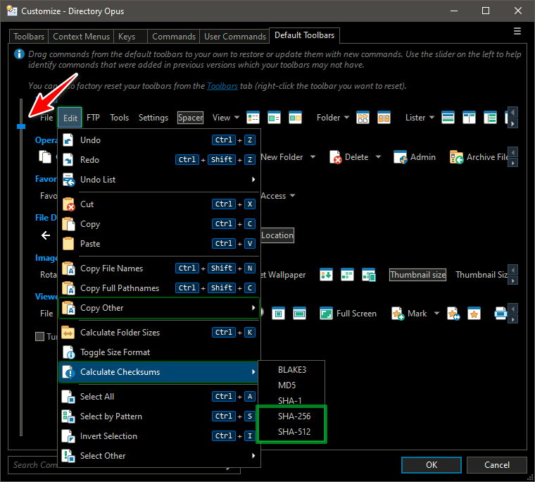

Or go to Customize > Default toolbars tab and use slider to identify new commands, and drag it to your toolbar.

All I have in the drop down Edit Menu is MD5, SHA-1 and BLAKE3, with exclamation marks.

If you don't see them in the Customize / Default Toolbars tab, check Help > About Directory Opus to make sure 13.18 (or 13.18.1) is installed. Maybe you're still on the previous version.
Thanks, I’ve done it. The calculate checksums menu has now appeared after I factory reset the menu toolbar again. Not sure why it didn’t work the first time.

The Default Toolbars tab has a slider on the left that lets you highlight things added after a given version, to help you find and add new things to your toolbars (if you don't want to completely reset them).
