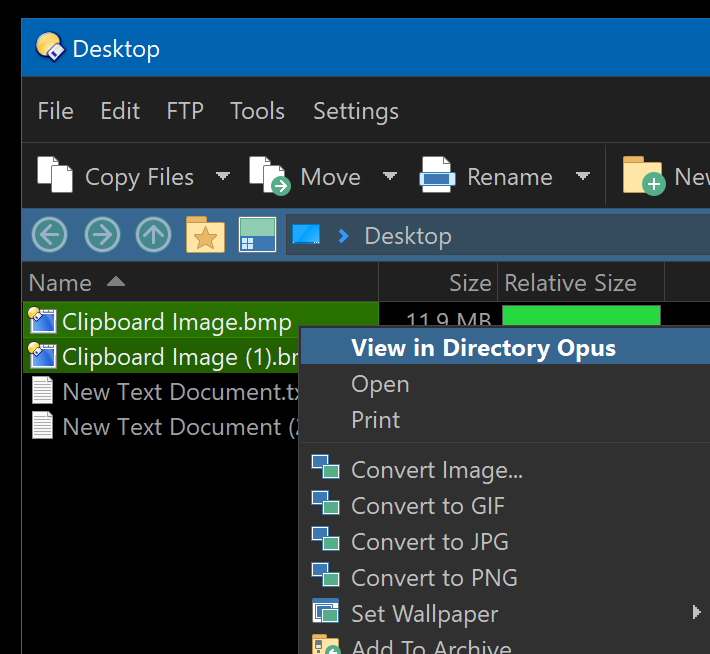

Which types of files are involved?

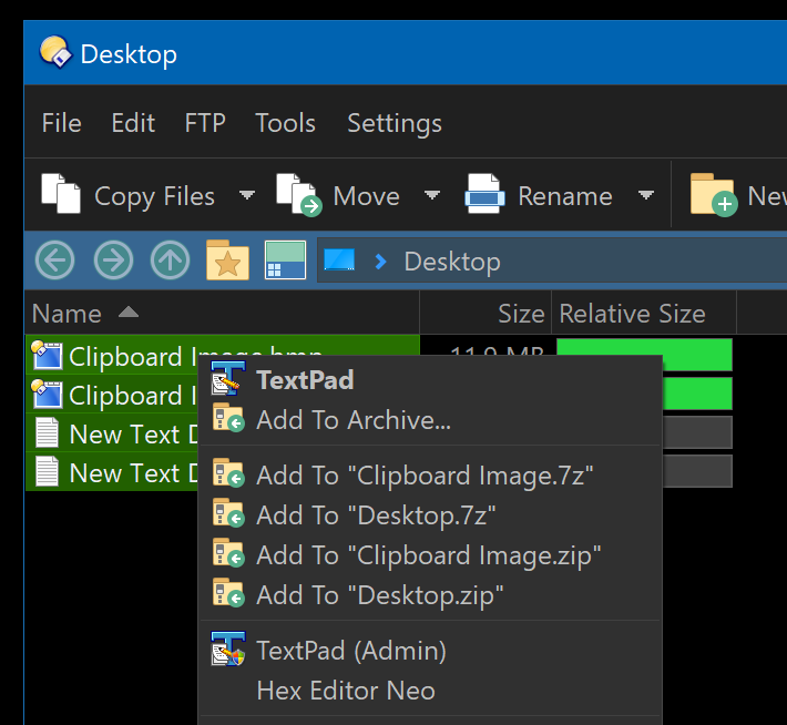

The only place with "View in Directory Opus" I can think of is the right-click context menu on files, but if I select a mixture of image and non-image files and right-click them, the option isn't there.

Context menus only show items that apply to all selected files/types. You'd have to add the command to something like All Files/Folders to make it appear in a context menu in all situations.
The Show command (e.g. within the Slideshow button-menu on the default toolbars) is always available, however.
