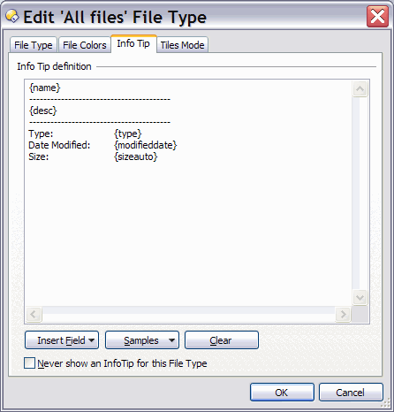

You can do that in SETTINGS/FILE TYPES/DIRECTORY OPUS FILE TYPES/ALL FILES. Click edit for that and then on the infotips tab where you enter whatever you want displayed for an info tip. The attached screenshot shows my configuration which shows:
File name
opus comment (if there is one)
file type
date modified
file size
You mean the setting shown below? (If so, that isn't connected to infotips. It's the Tile label.)

i had it already, like this:
But in this moment Dopus doesn´t show it anymore. Maybe i changed a setting?! ~^
Because of the "{name}" i included in the info tip list, there is supposed to be the corresponding info tip. By the way, another small issue: when i saw it working a couple of days ago, i couldn´t get it to be aligned in one row; the name field remained a bit "off", but that was quite ok for me :slight_smile:
(settings -> file types -> all files & folders -> edit -> info tip)

If the infotips don't appear at all then you may have turned them off. Type InfoTip (I guess "InfoTipp" in your German Opus) into the Preferences filter to find the relevant options.
If the infotips appear but don't contain the filename then you're probably hovering over files whose filetypes define their own infotips that override the All Files and Folders one that you've edited.
If you want to align things in InfoTips, use tab characters. I don't think you can type a tab into the InfoTip box (in the current version of Opus) but you can copy one to the clipboard and then paste them into it. (The infotip shown looks like it already contains tabs so you can copy and paste them to make more.)

aaargh, yes. That was it! why the file, i was testing it with, had to be a .pdf? of course you´ll one hundert percent right! But now, on this occasion, i´ve changed the info tip for PDFs to show the name.
hmm, ok, i will try that. I suppose i can insert a tab in a text editor & copy it from there? Anyway, this is cosmetical stuff, i´m happy that it "works again". :smiley:
Edit: yeah, the tab did it, everything´s aligned now! thx you all!
