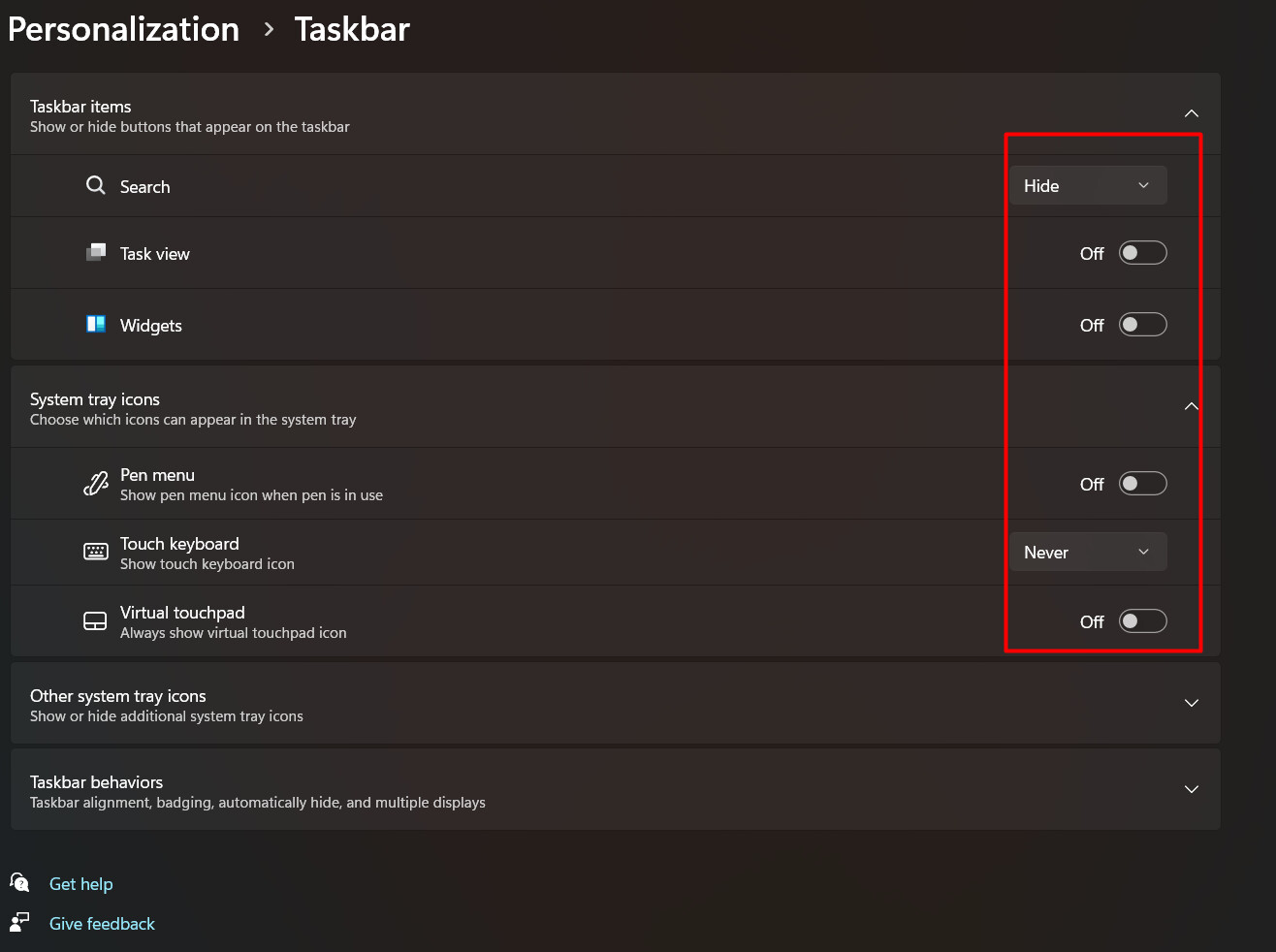

When DOpus loads, my Windows 11 taskbar disappears. I have to go to taskbar settings and enable 'task view' or something simlar to bring it back.

Changing any of the settings below brings the taskbar back...
If I close DOpus and start it again -> taskbard gone until I change one of the settings again.
