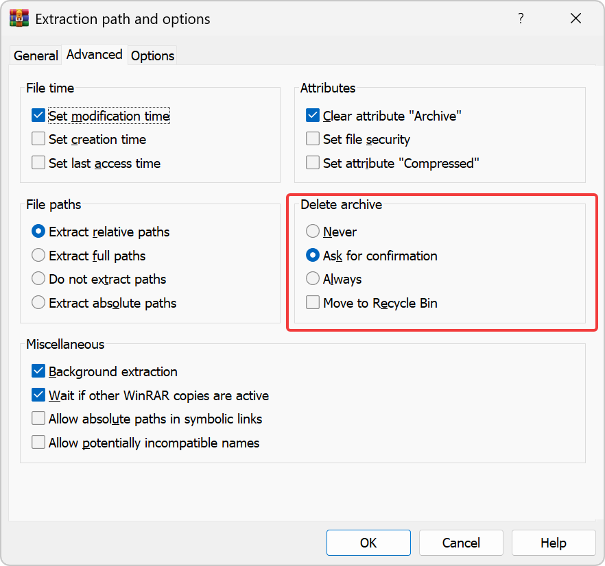

That setting is only available in the WinRAR UI. It cannot be changed on the command line.

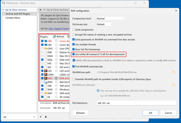

No, at best Opus will use the DLL if you check this:
The EXE will follow the settings here:
So to automatically delete the archive file you'd need to use the WinRAR context menu or a button.
It uses either unrar.dll or 7z.dll depending on your setup (Preferences/Zip).
I can't say if any of these offer the ability to do it. It is most likely something that is done outside of these lib, since it's not directly related to the compression/extraction process.
