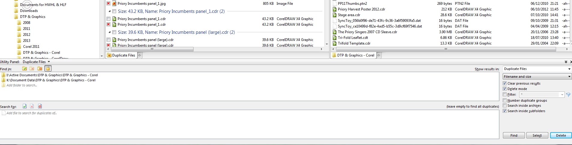

I am having several odd problems, the most recent being that it fails to delete selected files. The attached screen capture shows a few selected files (in fact there are over 3000 - I'm cleaning out an old disk) and below the selections I have made. I have selected the top level folders which have about a dozen folders below the top level. Yet when I click on Delete, the confirm delete box appears, I click on Delete, the box disappears but no files are deleted.
If on the other hand I try just selecting a sub-folder rather than the top level folder, it works fine.
I am using Windows 7 Pro 64bit.

I've just tried again and same problem. The delete button won't delete any files but I can delete files right clicking individual ones.
Note that if you want to delete files found through the Duplicate Files finder you have to use the Delete button in the actual Duplicates panel (at the bottom) - the regular delete button on the toolbar won't work.
Thanks but that is the one I am using.
