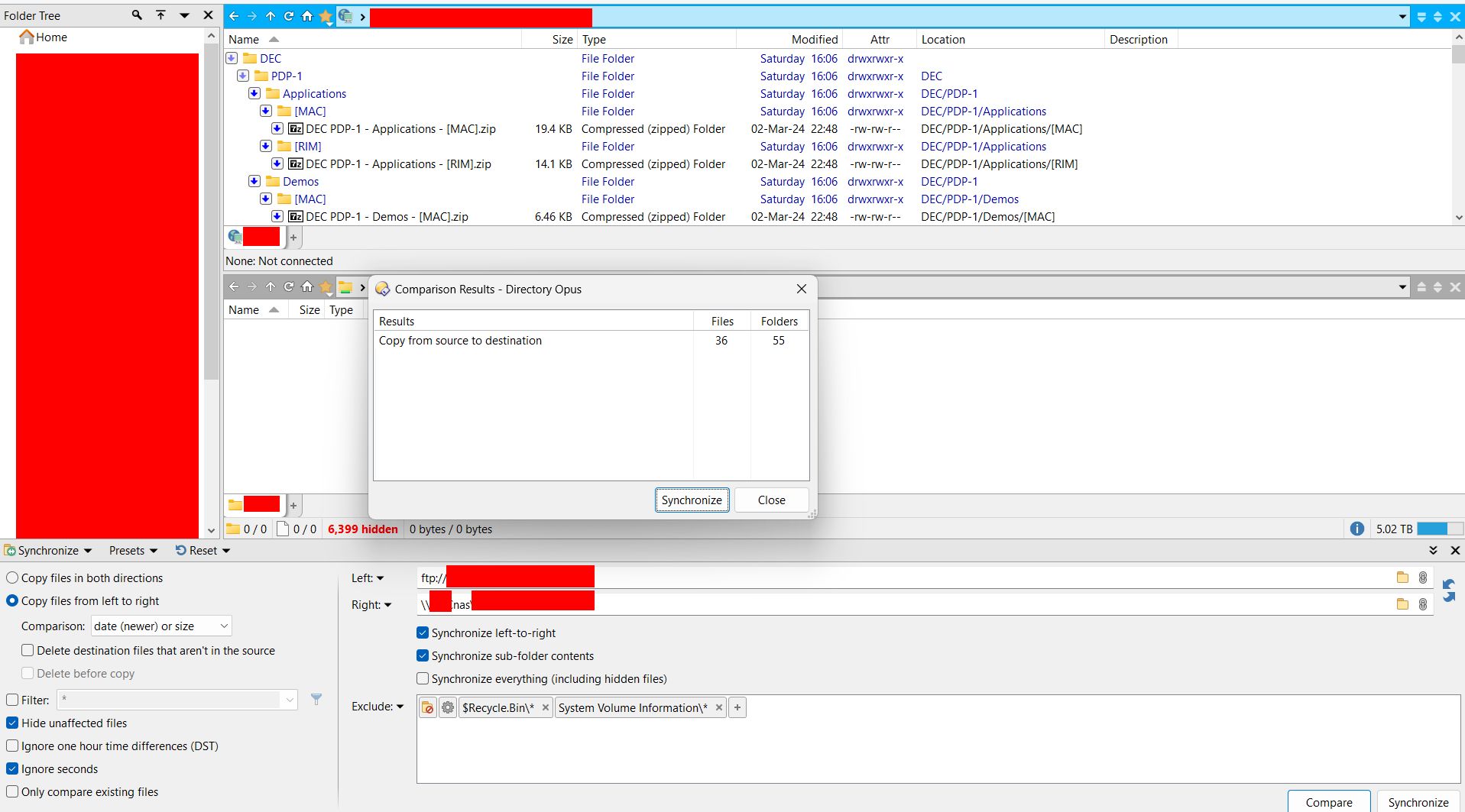

Thanks Jon for the quick reply. I will show you here the screenshot with the configuration. As you can see the compare show some results and will continue to show the same results after the sync. It is the third time that I've tried and nothing has changed:

Can you find those folders on the NAS device after they've been copied?
The common element seems to be [ ] characters in the deepest level pathname and I wonder if the NAS is changing the filename in some way.
Hi Jon, I've checked and the filename is identical in the NAS and yes, the files and folders are already there. Even in the previous screenshot you can see that I've flagged the option "Hide unaffcted files" and indeed the NAS window (bottom one) is empty. The result should be "No changes detected or required" but I will see the sync message over and over. Thanks for your support.
