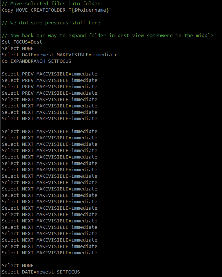

I have a few scripts that do special actions from the source pane to the dest pane, such as renaming and copying files from source to dest.
I want to visually check the result on the dest pane and therefore, need a command to finely control the position of the dest view to "what has just happened and its surroundings".
At the moment, I hack my way with this kind of script:
...but this is slow and cumbersome.
Is there any better way of doing this?

As you can see in my script, I have to badly emulate this with a lot of Select PREV and Select NEXT to obtain the part after Set FOCUS=Dest.
(and on top of this, I can only rely on an initial Select DATE=newest whereas I perfectly now the exact item I want to have the focus on)
Please also note the EXPANDBRANCH which is important in my usage.

In a way, this is what I emulate in my crude attempt with:
Select NONE
Select DATE=newest MAKEVISIBLE=immediate
Go EXPANDBRANCH SETFOCUS
If I omit the bunch of Select PREV / Select NEXT, then the item is displayed in the last position of the view (according to MAKEVISIBLE=immediate)
But this is not good enough for two reasons:
  1. the item can be in a branch. I try to circumvent this with Go EXPANDBRANCH SETFOCUS but then the item is not on screen, only the parent folder
  2. I really prefer to view the item near the top position and I also need to see at least a few lines before the item.
    As explained in my first post, this is to visually check the result of the latest action and the surroundings, e.g. "was there already a file with a similar name that I missed?"
I'm not proud of my hack code and as I said, it is very slow (the more Select you insert, the slower as Directory Opus inserts some delay each times)... but this is a real saver for me and I did include this in a lot of parts of my workflow.
