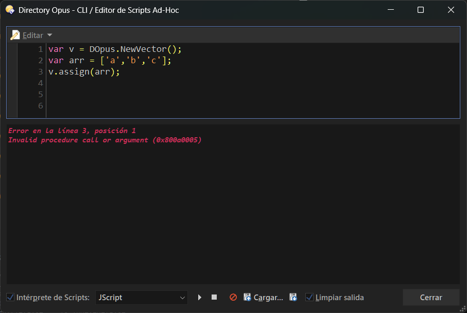

Now seriously, I think this change might have gone a bit too far. It seems to affect more than just Vars and setting forbidden things into it. A lot of my scripts are now broken, and I'll have to debug them one by one when I get the time. Note that the vast majority of this scripts don't even save jscript objects to Vars like the claim says. Some of them can be worked around, but unfortunately some can't.
A pattern I've noticed is scripts that somehow interact with JScript objects (even those "allowed" by the Opus scripting API). For example, you can no longer use Vector.assign() with a JScript array.

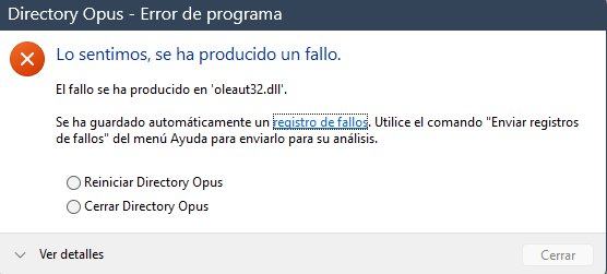

We had a crash from this just the other day :slight_smile:
Just because it doesn't happen all the time doesn't mean it can't happen. The fact remains is it's fundementally unsafe - jscript objects aren't meant to outlive the instance of the script engine that created them.

Just to be clear, I'm not arguing against the new policy regarding Vars; that's up to you since you know better. What I'm saying is that it seems like the fix is affecting things that shouldn't be related, like Vector.assign() with an array, and probably other things that will show up in the next few days.
Thanks for the additional info. I see what's happened now.
That's actually caused by an unrelated change in 13.22.4. The change in 13.22.5 is coincidental.
Will be fixed shortly.
People are often not good at diagnosing issues in the first instance, but the crash dump he sent was clear that it was caused by freeing a non-Opus object stored in a Vector.
Fixed in 13.22.6.
Thanks, confirmed.
