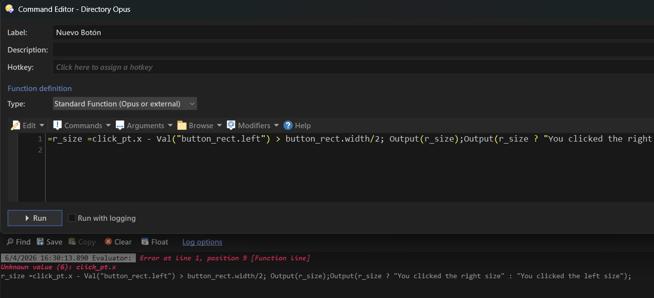

Another issue I see is that you can't access their properties at times. E.g.
=r_size =click_pt.x - Val("button_rect.left") > button_rect.width/2; Output(r_size);Output(r_size ? "You clicked the right size" : "You clicked the left size");
Gives this error:
However, it will work if you change it to something like:
=c = click_pt; b = button_rect; r_size = click_pt.x - Val("button_rect.left") > button_rect.width/2; Output(r_size); Output(r_size ? "You clicked the right size" : "You clicked the left size");
I'm not sure what's the reasoning here.

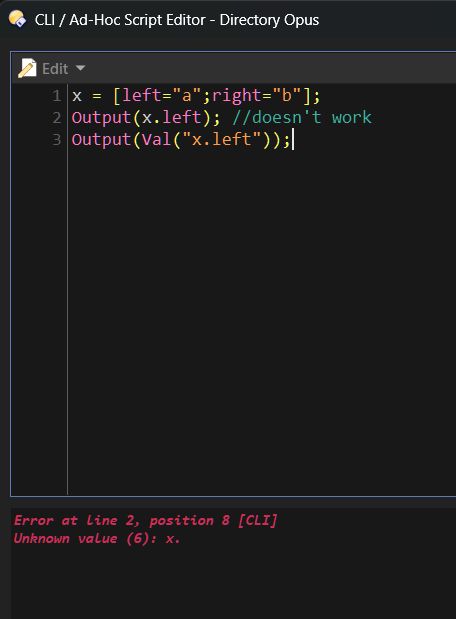

I think the answer is right and left are both Evaluator string functions as well.
The Evaluator parser doesn't have a bilingual brain.
Try x = [ l = "a" ; r = "b" ]; , then at least the first part works.
Edit 1: Thinking more about this perhaps that's what you really meant. But again that's the purpose of the function Val().
Edit 2: Does the second part error because there is not a space after the second = before click_pt.x ? I am only guessing now. I'll have to try this.
Edit 3 : I tried it.
You're right and I'm wrong.
The space doesn't help and your change to the code mysteriously works.
I should have stayed out of this. Sorry.
I overlooked that in the previous beta but it will work in 13.22.2.
